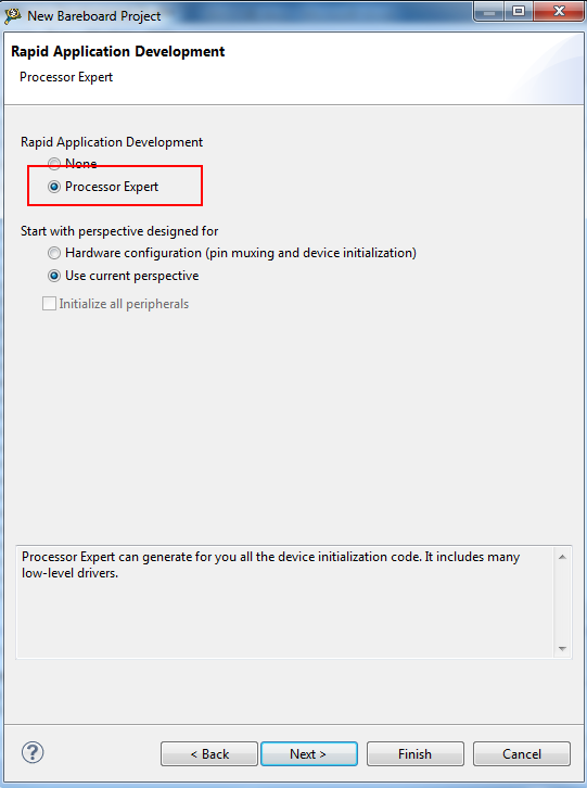

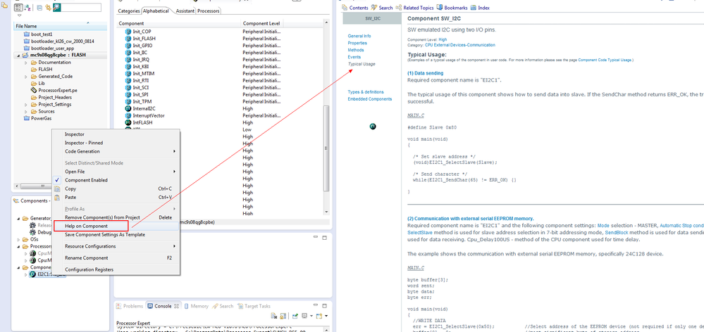

Hello Ron,
Which version of CW do you use ?  You can use the Processor Expert on CW , it provides I2C driver.
For example CW10.6,  when you create project , please select "Processor Expert"
then add the SW_I2C component
then you can refer to the "Typical Usage" to configure , there have the I2C demo :
Hope it helps

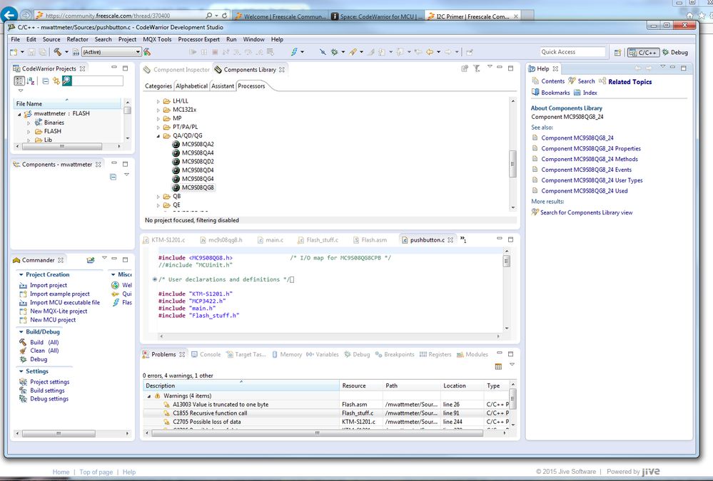

I am using code warrior 10.6 Special Edition.
I really need some help with the project I am working on.  I have followed the instructions and still can not find an acceptable solution.
I have created a new project that incorporated processor expert.
First when I select the processor type,  my specific chip is not included (MC9S08QGCPBE, which is the 16 pin version).  See screen shot.
Second, if I create a new project with out processor expert, the wizard allows me to select the proper chip.  Then I copy my source code into the project with the "add files" command.  This works.  However if I attempt to add any component via the Process Export menu,  the "add to project" is greyed out.  I can not add components to an existing project.
