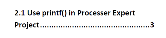

Hello Abner,
- If you want use printf to send date to PC , only need add the Processor Expert componnet "ConsoleIO",
then  configure it , about the detail steps please refer to the attached DOC,only need check the one part
of :
Please pay attention on which UARTport do you used on your board .
Hope it helps
