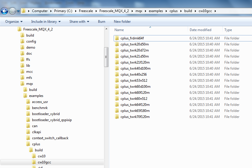

ZhangJennie
Hi su,
I use MQX4.2, I can find cplus demo code under
C:\Freescale\Freescale_MQX_4_2\mqx\examples\cplus\build\cw10gcc
