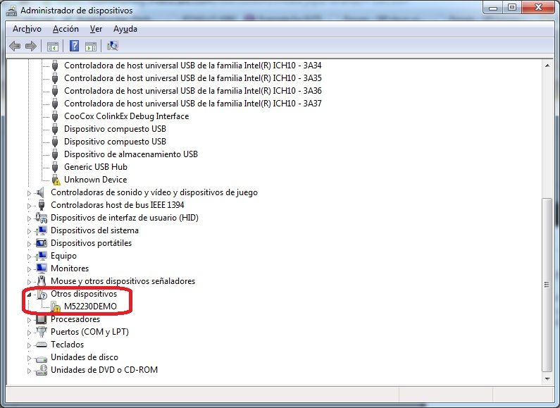

Hello , I have recently adquired a M52233DEMO kit. I have following the "Step by Step installation instructions" but it does not work fine.
ow can ido install the driver for Windows7?

I think it should be a driver issue.
It's an Axiom board.
I don't know if Axiom provided the driver for Win 7 and 64 bit OS.
The M52233DEMO board has 2 interfaces connector:
      - Integrated BDM_PORT using a sample USB cable,
      - BDM port using a BDM interface as P&E Multilink.
I will check with Axiom.
Your solutions are.
      - Install the board on Win XP machine (via VMware/Virtualbox or Virtual PC),
      - try to use the BDM port with an interface as P&E Multilink.

hugojesteszoilo
Hello Pascal,
I have resolved the issue by means of the installation of codewarrior 10.
do you know about  any example source-code/project ready for build and run into M52233DEMO board? ( for CW 10)

Hi Hugo,
Thanks for the very important info.
So it was a driver issue.
I don't know exactly what is the on-board BDM port used on this board but probably it's based on P&E.
