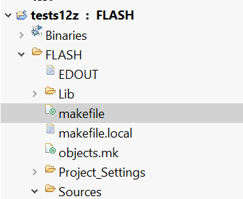

ZhangJennie
Regarding to your questions,
1. No, there is no other options can generate precompile file
2. makefile: CW IDE can automatically generate makefile, you can find it under the project folder after a successful build.
Hope this helps,
