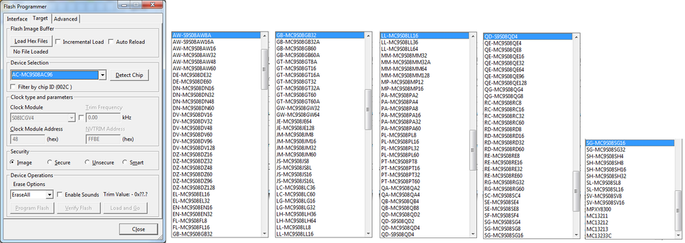

I try to program flash on FXTH870XX sensor, but have failed.
How I understand I have 2 ways, use USBDM (I have like this) in codeWarrior or in HCS08 Programmer.
In first way I don't have any idea what to do, ho to integrate it.
In second way I try to use HCS08 Programmer (I installed USBDM_4_10_6_80_Win). And on the tab (Target) I have to choose my device, but I can't find it (FXTH870XX). When I click Detect chip, target try detect, but then show "no matching device". So for this reason, I can't program flash.
So please help me, what I do wrong, or how to connect my USBDM adapter to the codeWarroir.17156_17156.pngflash programmer.png

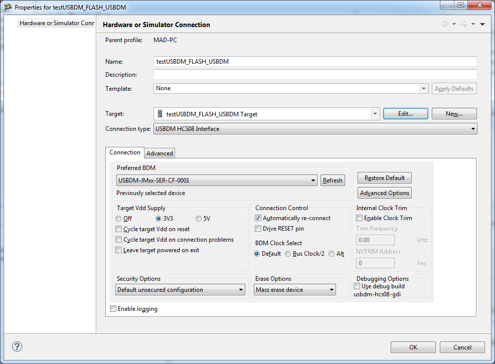

I set up a CodeWarrior like here.
And now codeWarrior start to use adapter for debug. But when it try to flash program (power led blinking), it got faild.
I think mb it need special initialisation?
I tried different, but all failed. If somebody have any ideas (mb need to set clock trim, but I don't know what time exactly), please help me

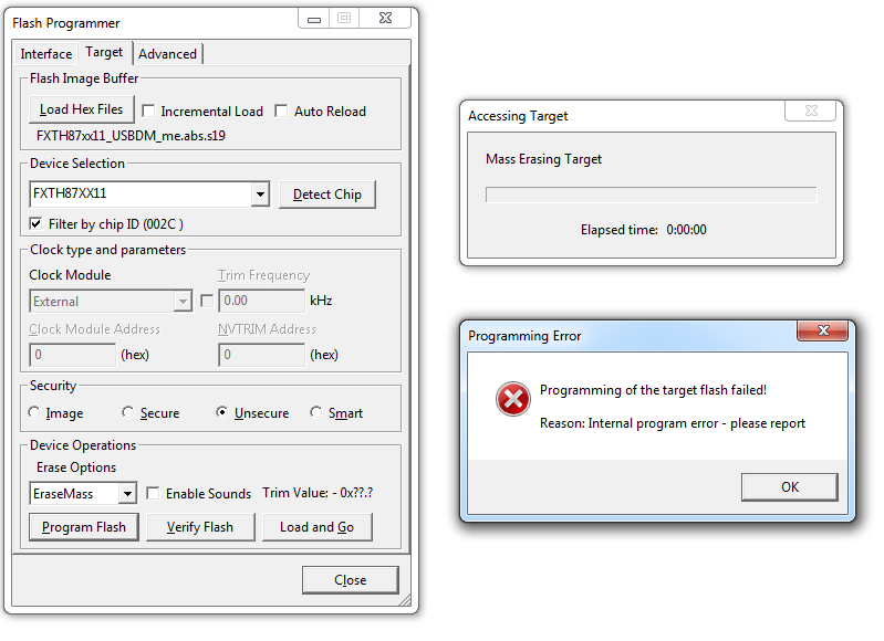

Thank you for your reply. Of course I installed this CodeWarrior and try to flash this project. But have failed (error: "Failed to resume target process. Downloading binary to target.")
Also, I try to flash in USBDM. To add FXTH87xx11 in the Flash Programmer I insert this in the hcs08_devices.xml:
     <!ENTITY HCS08-alt-load-flash SYSTEM "HCS08/FXTH87xx11_Starter_Project_CW10.abs.s19">
     <flashProgram id="HCS08-alt-load-flash">
          &HCS08-alt-load-flash;
     </flashProgram>
     <device family="HCS08" name="FXTH87xx11">
          <memory type="ram">
               <memoryRange start="0x000090" end="0x00028F" />
          </memory>
          <memory registerAddress="0x1820" type="flash" securityAddress="0xFFB0">
               <securityEntryRef ref="HCS08-fnored-security"/>
               <memoryRange start="0x00C000" end="0x00DFBF" />
          </memory>
          <sdid value="0x002C" />
          <flashProgramRef ref="HCS08-alt-load-flash" />
     </device>
I'm not sure thay I use right values especially securityEntryRef section. But now flash Programmer detect my chip. But when I click Program Flash, on EraseMass status pop up error:

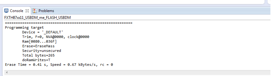

I found strange thing. When codewarrior tru to flash program, it show in console:
1) Device "_DEFAULT@", why not FXTX87? Where I can set my chip?
2) RAM (0080...036F), but in datasheet and in FXTH870000.mem file 0x0090 0x028F. Mb this is a reason? But how to correct it? or it's normal.
