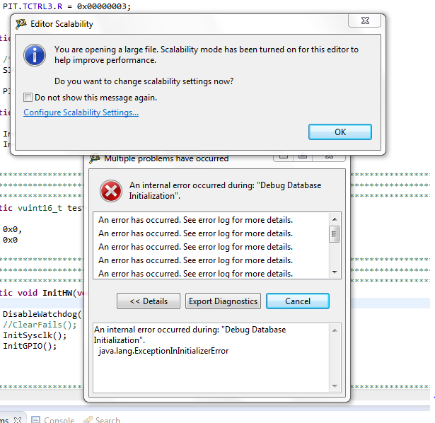

How to fix the issue occured while opening codewarrior 10.6

Thank you for your concern Jennie Zhang.But I'm getting not only the scalability issue but also i couldn't create the new project file.Hope i get solution for this.
Thanks in advance!

Hi Chennam,
I would suggest you remove your .metadata folder of your workspace, then try create new project again.
You may need backup your .metadata before the removal.
Jennie Zhang

I'm using MPC5643L controller

Besides, Please check if this article can help you
Eclipse Editor Scalability | MCU on Eclipse

Could you tell us which MCU are you using?
