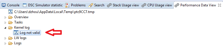

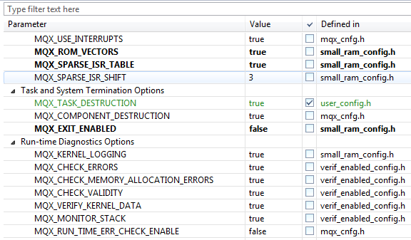

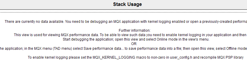

I have K60Tower board: _K60P144M150SF3RM, with MQX4.2 version, and CodeWarrior 10.6.4 Version
My MQX 4.2 project was be able to debug kernel with Stack Usage, and CPU usage. For some reason, now it doesn't show those views.
Where is the problem?
Thank you,
David Zhou
1,802 Views
davidzhou
Contributor V
OK, I is resolved. Need to SAVE PERFORMANCE DATA under menu MQX first.
