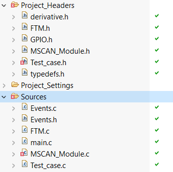

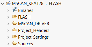

Second, copy and paste from the non-PE project to the new PE project (now is not)  the folder name MSCAN_DRIVER. Do I need to import it in a different way to the project that contains the SD part?, I just copy and paste it.
Third copy and paste all the .h and .c files from non-PE project to the new PE project (now is not)

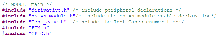

Fourth, Include in the main.c all the .h files I copy

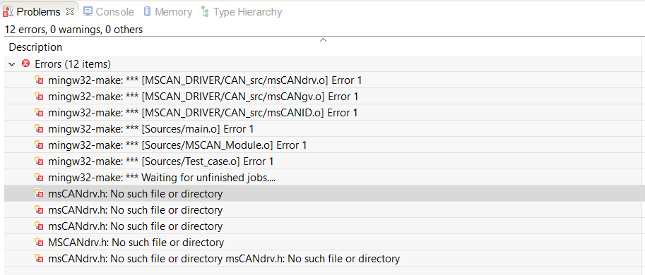

Doing this a have errors that I don't know how to solve it , does anyone have an idea of what I'm doing wrong? The erros I got are the following

Hi Emilio,
it's not difficult to get rid of these errors
just add the related path
"${ProjDirPath}/MSCAN_DRIVER\CAN_inc"
"${ProjDirPath}\MSCAN_DRIVER\CAN_cfg"
to project directory setting you can do it:
