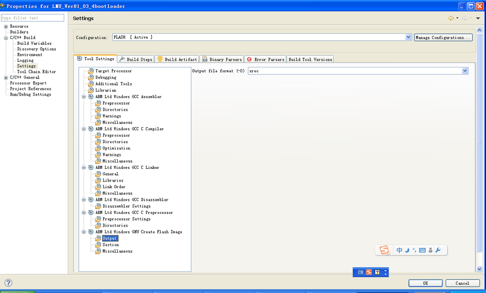

I make s19 file by code warrior 10.6.4.FSL_b06015 as below .
S01000004C4D555F56657230302E686578A2
S214000400FFFFFFFFFFFFFFFFFFFFFFFFFFE4FEFF13
S2140040000030002011640000F5600000CDE50000DF
S214004010CDE50000CDE50000CDE50000CDE50000D3
S214004020CDE50000CDE50000CDE50000CDE50000C3
The data length is 16(dec),how can I change it longer?(ex. 32(dec))
Thank you!

Hi Jason,
I'm using the SRecord tool for this: SRecord 1.64
See https://mcuoneclipse.com/2015/09/23/aligning-s19-records-to-64-bit-boundaries/
and the option -Output_Block_Size
I hope this helps,
Erich

Hi Erich
It is great !
Thank you very much!
Jason
