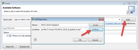

In order to install the plug-in in CodeWarrior you need to follow these steps:
  1. Start CodeWarrior.
  2. Use the menu Help > Install New Software
  3. Use the your plug-in file as local update archive: Click the 'Add...' button, then use 'Archive...' to point to the plug-in file.
  4. Select the update(s) and go through the installation process with "Next >".
  5. Restart CodeWarrior at the end of the installation process.
Hope it helps!
