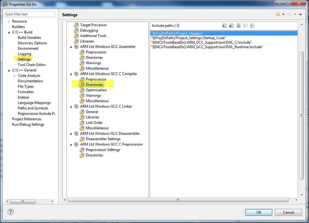

I have to add MSCAN driver of TRKKEA128 to Code warrior IDE.  This driver has 3 folders in it CAN_cfg, CAN_inc and CAN_src.
Earlier I used to copy and place the header files to Project_Headers and source files to Sources.
But I know there is a method in which we can include the folders to compile independently rather than moving it into Project_Headers  and Sources.
Could you please tell me where should I include the paths.
6 Replies
3,319 Views
ZhangJennie

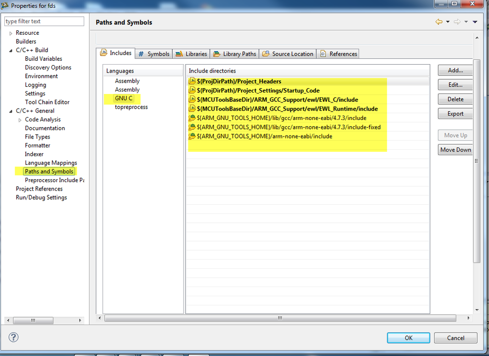

hello David.
please check settings as below:
can this help you?

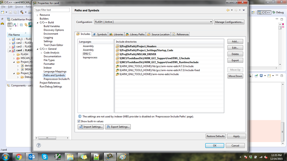

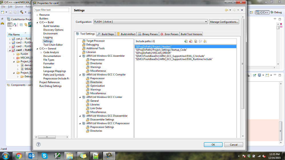

Hi Jennie Zhang,
The above pictures are same even in my case. I created a new project.
And then added a new folder MSCAN_DRIVER  and included that path in Settings->Directories->MSCAN_DRIVER.
This automatically added the paths in "Paths and Symbols->GNUC->".

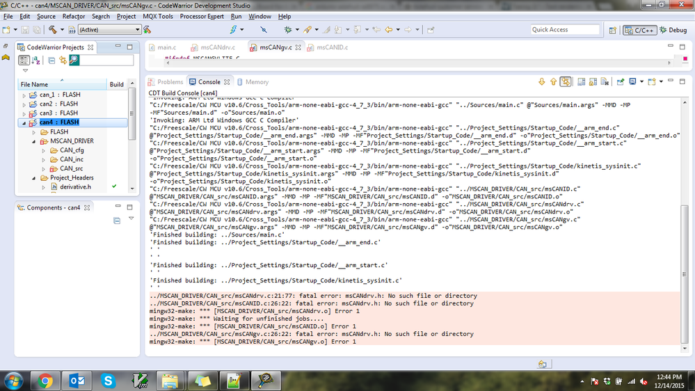

But when I build the project, it shows msCANdrv.h file is not found. But it is found in "MSCAN_DRIVER/CAN_inc".
I have attached the screen shot here for reference..
Let me know if I am missing something.

Hi Jennie Zhang,
I added separate path for MSCAN_DRIVER/CAN_inc and MSCAN_DRIVER/CAN_cfg.
I got it working.
