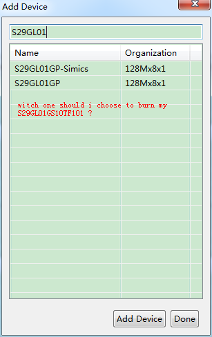

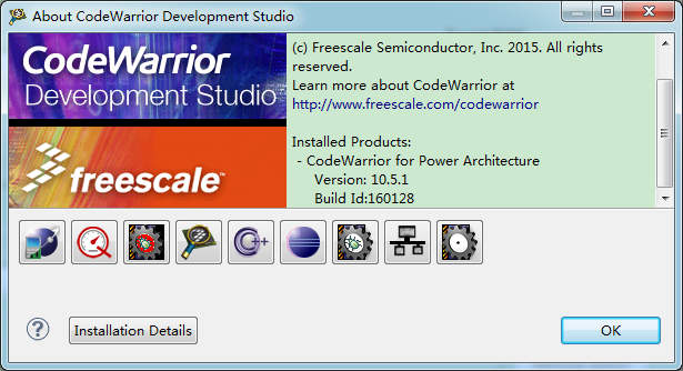

When i add device during new a target task, I can't find my flash model, can i choose one of them to burn my S29GL01GS10TF101? and why ?
I am looking  forword to your reply!
Thank you!

Hello xuchen,
You'd better add a new device for the NOR if that's not in the list.
Refer to AN4349 Adding Device(s) to the CodeWarrior Flash Programmer for Power Architecture® Processors.pdf:
http://cache.nxp.com/files/soft_dev_tools/doc/app_note/AN4349.pdf?fsrch=1&sr=1&pageNum=1
Also you could have a look:
Adding nand flash(MT29F2G08ABBDA) support in CW 10.3
