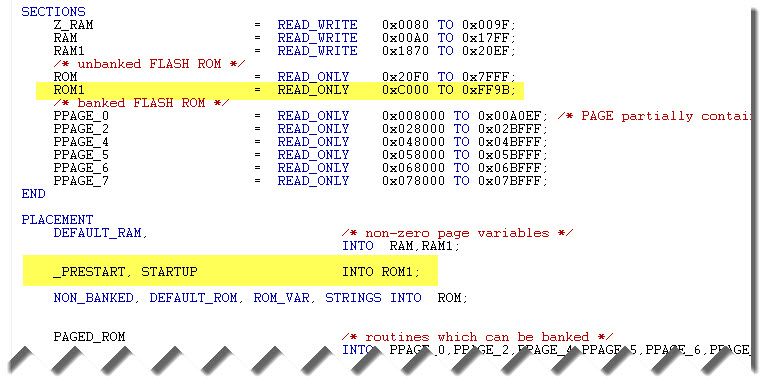

segment "_PRESTART" is for application entry point is stored in the segment _PRESTART. This segment must also be associated with a READ_ONLY section.  that's to say, bootloader_main must be defined in "_PRESTART".
Let's take an example:
in above prm file, _PRESTART is defined in ROM1(0xC000 to 0xFF9B), thus with code
INIT bootloader_main
bootloader_main is defined in ROM1 section.
if you want to relocate bootloader_main to other section, we just need change _PRESTART placement in prm file.

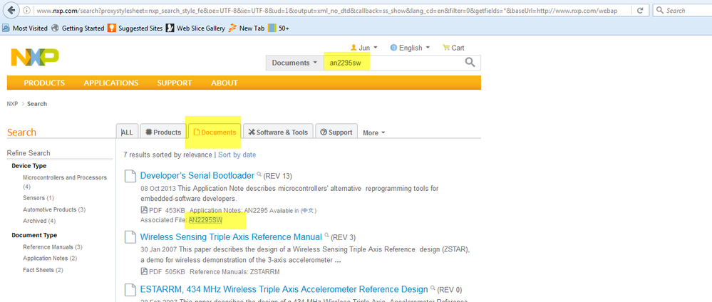

to get an2295 full version, please download it from NXP web site by searching AN2295SW on NXP web site.
http://cache.nxp.com/files/microcontrollers/doc/app_note/AN2295SW.zip
