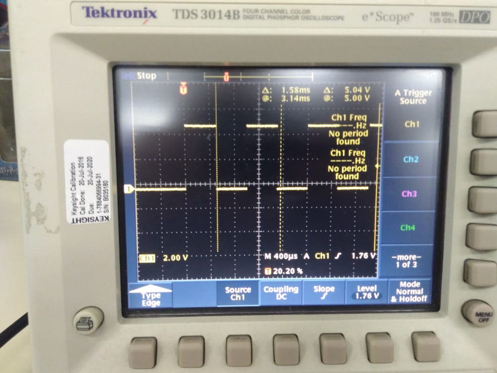

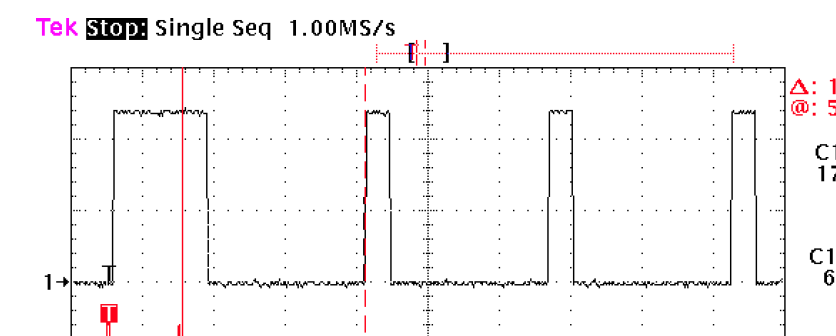

Hai,
 Am using  MC9S08SG8 micro controller ,and am using code warrior V6.3  software ,here am using PWM in 7th pin ,
 my problem is in  output duty cycle  first pulse is grater then the other pulse ,like this. plz any one can help me.
Capture.PNGThanks  in advance ,
karthik

venkateshgv
thanks for u r reply ,i try this code same problem has occuring.
6,873 Views
vicentegomez
In my code, it starts in low, it takes a little bit more, due to the power on set up, but after that, all the pulse are the same
