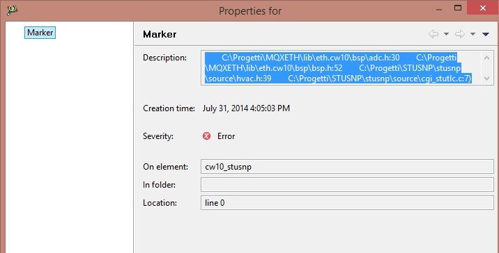

Good morning,
when I compile, I'll get a generic error but I don't understand the meaning.
Following the error.
I understand that in adc.h line 30 there is an error, but which is the error?
I don't modify the bsp project!
Thank you
Best Regards
Mirko

Could you show the entry in the Problems view?
and what is written in the Console view for the build?
What I think is happening is that the build tool has created some error messages (you can see them in the console view) which are not understood/parsed in the Problems view.
Erich

kappa74
I showed the proprieties of a single error but I get a lot of errors, as you can see below.
In the Console view I can’t see all the error because they are too much.
How can see the first error?
It is not displayed.
Mirko

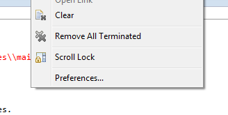

BlackNight
You should see the first error if you scroll to the beginning of the Console view/list.
But it seems that your MQX project is screwed up.
Have you copied that project around? It looks like the paths are not setup properly.
Erich

kappa74
I'd like to see the first error in the Console view/list but it is impossible because the scroll doesn't stop itself and I see only the last errors.
How can I see the first error?
How can stop the scrolling?
I made the project in CW12 with MQX3.8.1 and now I want to pass in MQX10.6 with MQX4.1.0 and I have these problems.
The project is mine in not found around.
Mirko

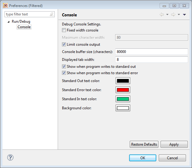

BlackNight
Right click on the console view output area, there is a 'scroll lock' option.
Additionally, you can increase the buffer size: right click on the output area, select preferences.
Then increase the console buffer size (characters) to a higher value.

kappa74
I'm sorry but the Scroll lock doesn't work because the scrolling is stopped but the consolle window is update by page instead of by line.
I'll try to increase the buffer size.
Thank you
