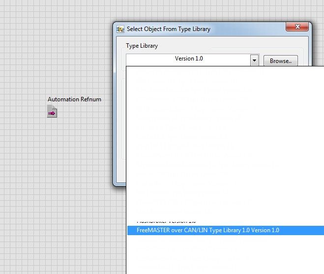

I'm trying to control and retreive data from a Freemaster application;
I can access it through the web browser as follows:
<object style="WIDTH: 0px; HEIGHT: 0px; " id="pcm" name="pcm"
classid="CLSID:48A185F1-FFDB-11D3-80E3-00C04F176153">
</object>
<label id="lbltipAddedComment">test</label>
<script>
  document.getElementById('lbltipAddedComment').innerHTML = pcm.GetAppVersion();
</script>
However from Labview I cannot find the right ActiveX class, i find only this class:
Where should I find the correct ActiveX class?
thanks in advance,
agostino

Resolved selecting "Browse" -> and getting directly the application "pcmaster.exe" from Program Files (x86)/Freescale/
See also this discussion on Labview forum ActiveX automation with classid for Freemaster
about the same topic.
