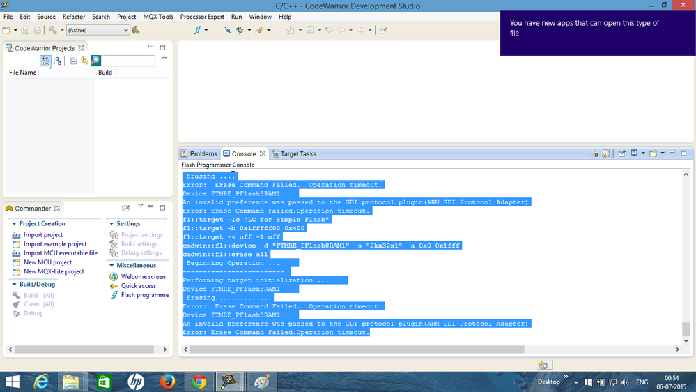

Helllo,
I have developed a custom KE04Z8- 20pin SOIC based board. I am able to download and debug the program using Main Source Code Project.
But when i use the Flash File to Target option by browsing the Hex File, I am not able to download into the device. It is giving below errors. Please suggest. I am attaching screenshot for the same.
Regds,
Dhruv

BlackNight
as noted in the error message of that dialog, you need to specify a target task name.
See that edit box at the bottom of the dialog: specify a name like
MyFlashToFile
or something like this.

dhruvonline
Thanks for the response.
I have added the Task Name Also. See the error observed in the second page.
Regds,
