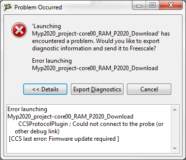

I am trying to connect to a target system which is based on p2020 via CW-TAP and using CW- IDE, but I am getting the following error:
Error launching Myp2020_project-core00_RAM_P2020_Download
CCSProtocolPlugin : Could not connect to the probe (or other debug link)
[CCS last error: Firmware update required ]
I did update the firmware by connecting to CW-TAP using ccs.exe in win7 and following command, but I am still getting the same error when I connect to CW-TAP in IDE environment:
(bin) 1 % updatecwtap --force 10.92.6.50
10.92.6.50 is running OS version 1.0.1
Update contains OS version 1.0.1
WARNING: Update forced - overriding version check.
WARNING: UPDATING FLASH - DO NOT INTERRUPT!
Sending code to CodeWarrior TAP.........done
Running package script
Erasing kernel partition...
Flashing kernel partition...
Erasing root2 partition...
Flashing root2 partition...
Activating root2
Update completed; rebooting.
Waiting for reboot...
10.92.6.50 is running Boot Loader version 0.9.2
Update contains Boot Loader version 0.9.2
Erasing uboot partition...
Flashing uboot partition...
All updates completed successfully.
(bin) 2 % updatecwtap 10.92.6.50
No update needed (use '--force' to reinstall).
(bin) 3 %

What's your CodeWarrior version? The latest one on CW_DSPA: CodeWarrior Development Studio v10 for Power Architecture® Technology (Eclipse) is 10.3.3 and it supports Windows 7 SP1.
