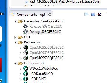

unclemike
Hi Jennie:
Thank you for responding.   On  the Processor Expert pane under "Generator Configurations" it has the wrong MCU in both projects that work and projects that don't.  I don't see where I select it when I am using the New Project wizard, and I can't find where to change it after the project has been created.  I select MC9S08QE32 when I am given a choice, but it seems to use whatever it fells like for the package suffix.  On the project that works under "Generator Configurations" it has "Debug_S08QE32CFT". On the project that does not work it has "S08QE32CWL.  The MCU is really a MC9S08QE23CLC,
On the Processor Expert pane under  Processors it has the correct MCU ( it says Cpu:MC9S08QE23CLC).  I can change that one by opening the hardware perspective and clicking on the "Select Package for the Processor" icon.
I have tried to select the correct MCU in the Components Library-> QE-> MC9S08QE32.  I double click on MC9S08QE32 and select the CLC package
I don't know if any of this has anything to do with my problem.  I was able to debug this project when I first made it.

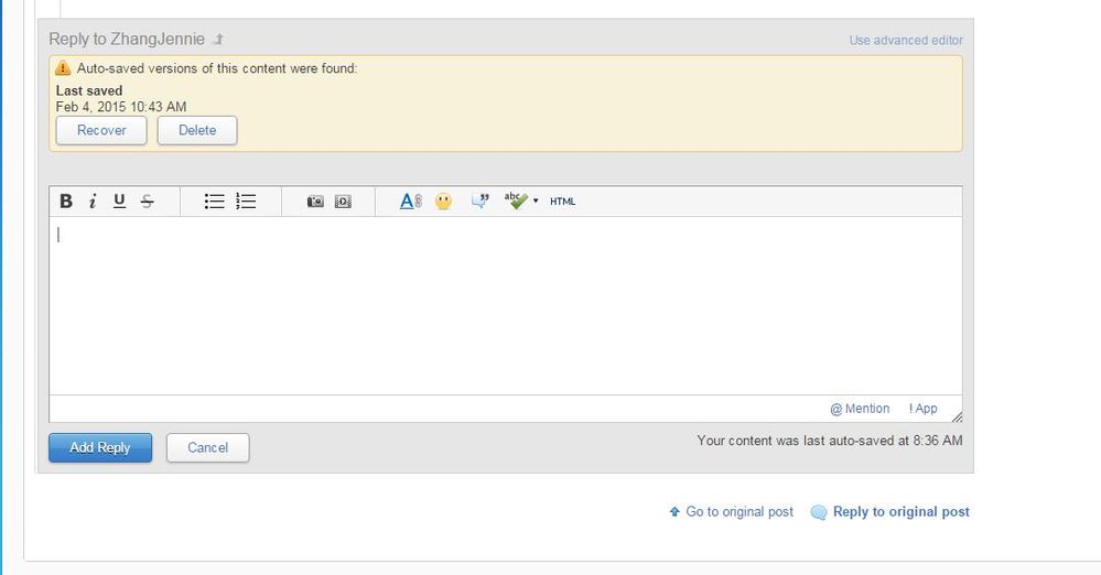

unclemike
Hi again:
This is the window I see.  there is no 'attach' in the lower right.
noattach.JPG.jpgH
However, since I can insert images, here is a shot of my screen.
Maybe it would be better if I took a different approach.  I am going to try to start a project from scratch and then see if I can find a way to move the Processor Expert files from the old project to the new one.  I was hoping  to avoid all those dialogs.
