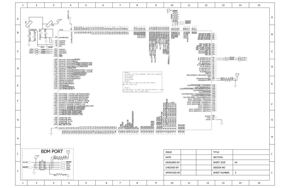

I have installed codewarrior 8.8 in windows 10 x64bit and using a codewarrior USBTap to debug MPC860 processor. I also installed patch 8.8.6. I have connected USBTap to 10-pin BDM connector.  While trying to run the code, it is showing errors like "target cannot be reset" or "network timed out" or other errors.
I have not connected XFS capacitor (since it's a BGA, cap can't be connected now) and using in x1 PLL speed. My input clock in 66Mhz and getting OUTCLK of 66MHz. Is there any problem with this.
The pins HRESET and SRESET are pulled up with 4.7K resistors.

Check TRST connection on your board.
The TAP signals must be configured as follows to reset the scan chain logic: If both the TAP and low power mode are never used, connect TRST to ground. If the TAP or low power mode is used, connect TRST to PORESET. If power down mode (the lowest power mode, where VDDH is disabled) is used, connect TRST to PORESET through a diode (anode to TRST, cathode to PORESET). The TRST has internal pull-up resistor. Typical value of this resistor is about 5kOm but can vary by approximately a factor of 2.

I have connected TRST to ground and checked. The problem remains the same.
I don't have MPC860FADS board. I have tested under Windows XP. It is showing the same error.

I am using the below-attached schematic for the above-explained problem.
