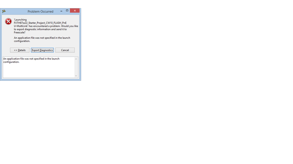

Hi Pascal
I am a student at Glasgow Uni, working on a TPMS project and we have chosen the FXTH87 chip for our design.
I have followed through the comments thread and installed CodeWarrior 10.6 with the Service Package you recommend here.
I also manage to build the project and look at the code and I see the binary files. Nevertheless, I cannot run and debug it - whichever simulator I choose I get the same error.Problem FXTH87xx Run demo code.png
Do you have any idea of what my problem might be and how I can get past it?
Kind Regards
Minko

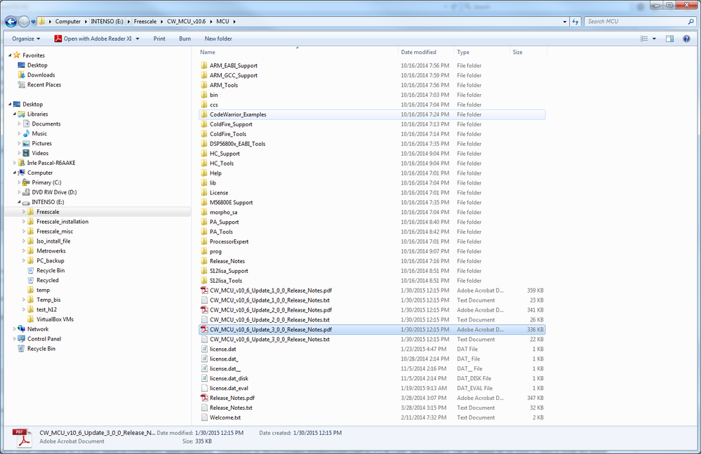

trytohelp
Hi Minko,
do you have access to the FXTH family under project Wizard dialog ?
To access you must click on File + New + Bareboard ...
To know if you've installed or not an update, go to installation folder \CW_MCU_v10.6\MCU
Some release notes are available.
This will give you information regarding the update installed.
Pascal

11,455件の閲覧回数
minkodaskalov
Hi Pascal
Thanks for the help. I have updated to 3.0.0 and I have run through creating a new project about the chip. The full chip simulator runs now I can debug although as you say the project code does not have much to it. Am I to presume that the project has things set up so that I can just start collecting instrumentation data and transferring it over the RF link?
My idea was to use the demo project in the supporting docs on the website. I wanted to modify it a bit to do my application since the other project is rather bare.
But as mention I do have the error popping up with it. The project is: FXTH87xx11_StarterProject_CW10 .
Kind Regards
Minko
11,455件の閲覧回数
trytohelp
Hi Minko,
I've downloaded the project.
I've imported it under my MCU V10.6 .
By default the project includes the abs file and other object code files.
If you build the project you will get an error:
Description    Resource    Path    Location    Type
mingw32-make: *** No rule to make target `C:/Users/R11515.FSL/Documents/SASD_Projects/Suzuka7/Enablement/Starter Projects/FXTH87xx11_Starter_Project_CW10/Project_Headers/../Sources/Interrupts.c', needed by `Sources/Interrupts_c.obj'.  Stop.    FXTH87xx11_Starter_Project_CW10             C/C++ Problem
As you can see it's a reference of an absolute path.
the right way to solve the problem is to:
       - clean all -> Project + Clean
       - Build.
now the project is built without problem.
Pascla
