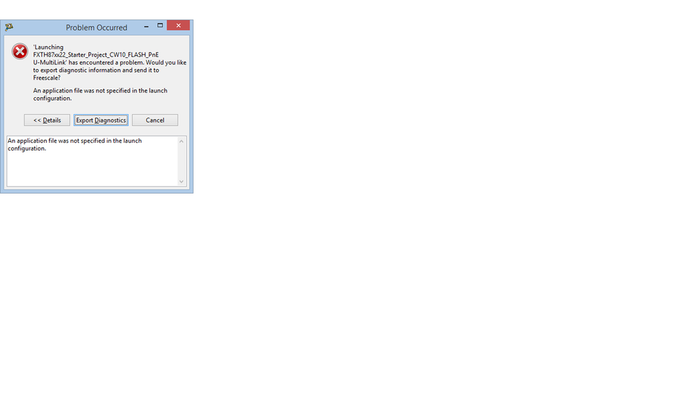

3,198 Views
trytohelp
Hi Minko,
Do you refer to ...
This means not application file was found.
There is a problem with the project.
After you have build the project you should be able to launch the debug.
Now each debug configuration is configured to download a specific file.
Can you check you've build the right project ?
Pascal

riccardocescato
I didn't see sorry!
I installed every service pack now for my CodeWarrior. ( I have 10.6 version but everything works)
However I have a problem with the PE Multilink now.
When I try to download the firmware on the TPMS sensor using my PE Multilink this error occurs:
"Launching -FXTH87xx22_Starter_Project_CW10_FLASH_PnE U-MultiLink.launch- has encountered a problem.
An application file was not specified in the launch configuration."
Then I saw that inside the folder : Project_Setting/Debugger of the Starter_Project for FXTH8700 there are only .launch files.
Differently to other starter_projects for mpxy8600 sensor, the .pemicro file is missing.
Could be this the problem??
Where can I find it?
Riccardo
3,198 Views
trytohelp
Hi Riccardo,
I don't have the FXTH board.
I've performed some tests with a TWR-S08PT60 with Multilink Universal rev B.
for this test I'm using MCU v10.5.
I've created an project example for FXTH and PT60 with Multilink interface.
On my PT_60, after to have build the project I can load the application on-board with Multilink without problem.
I've checked the 2 projects and they are very similar.
On MCU v10.6.
with the wizard I've created 1 project for FXTH and 1 for MPXY.
2 projects are very similar and I don't have .pemicro in the \test_mpxy\Project_Settings\Debugger too.
Can you try with a sample example based on project wizard ?
Pascal Irrle
