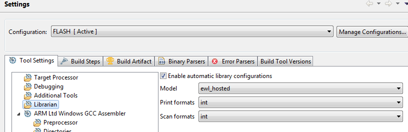

I tried flashing the binary (without starting a debugging session) for the bootloader application, then got the bootloader to install an example application that came with the serial bootloader, and it worked. After looking through the build settings for each application, I realized I had left semi-hosting enabled on the problem application :smileysilly:
At the moment I'm assuming this would be the cause of the problem, I will post again later if this is indeed the problem.
