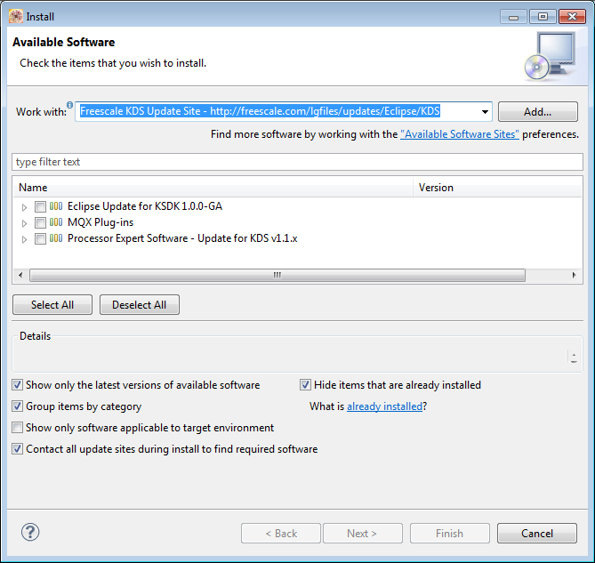

As another thought: can you check if you have all the updates (menu Help > Install new software) installed from the KDS update site?
