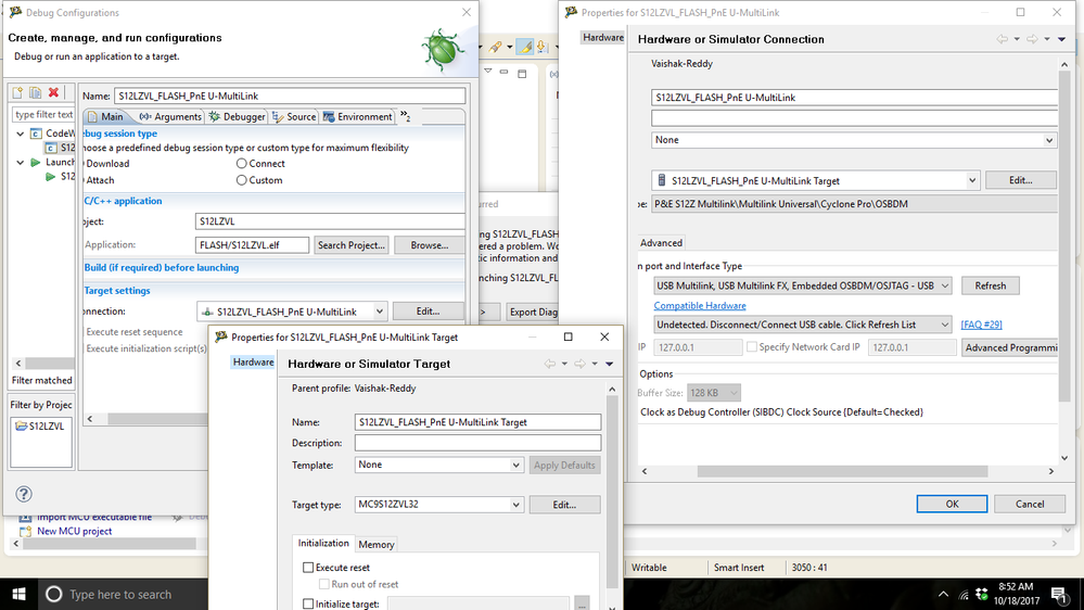

I use code warrior for debugging, when I try to flash S12LZVL32 I get this below attached error. Tried to reset it but no use. What can I do?

- What's the version of your CW?
- Demo boar or custom board?
- Show the debug configuration of yours in detail,  the debug configure view like below :

Version of CW: 10.7
Demo board or custom board: TRK S12ZVL(MC9S12ZVL32) 48 pin
I am attaching debug configuration details below.

Hello Vaishak,
From your screenshot we can see CW didn't detect USB multilink connection:
Please check device management of your PC whether detect OSBDM driver:
If didn't detect, please refer to  the Quick Start Guide to install latest P&E driver and also
check the jumpers on your board:
https://www.nxp.com/docs/en/user-guide/TRKS12ZVLQSG.pdf

vaishakthippire
It detected but still it is showing same error.
3,070件の閲覧回数
Change to a new CW workspace and a new simple project to have a try.
