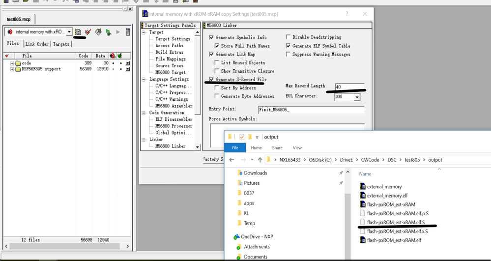

Dear Sirs, please help me. With the help of the “Parallel Command Converter” programmer and “FlashOverJTAG”, I copied the P- memory  and the X- memory (chip DSP56F805FV80E). As a result, I have two files readout_p.S and readout_x.S. When I try to write using “FlashOverJTAG” and the same programmer, I get a bad situation — after writing the file “readout_p.S”, I then write the file readout_x.S, and the already recorded file “readout_p.S” is erased!
What's my mistake? Maybe I need to compile the shared file “readout.S” of two (readout_p.S and readout_x.S), but I don’t know how to do this or the reason may be something else. I ask your advice.

The DSP56F805 has dedicated program flash and data flash, the two flash are separate, so flash-over-jtag tools should erase separately.
Anyway, you can download the *.elf.S as the following screenshot, in the case, both program flash and data flash will be written. Regarding how to generate the SRecorder file, pls refer to the following screenshot.

I do not quite understand, from your screenshot, how the SRecorder file is generated. I have two files readout_p.S and readout_x.S, do I need to rename them to readout_p.elf.S and readout_x.elf.S? But I did not understand, from the screenshot where is the link to the two files to compile? I apologize for my meticulousness.

The screenshot describes how to generate the S-Recorder file with CW for DSP56800E tools, if you configure the CW for DSP56800E tools as the screenshot, the THREE S_Recorder files will be generated: readout_p.S and readout_x.S and the merged readout_x.elf.S, you can download the readout_x.elf.S, it is okay.
