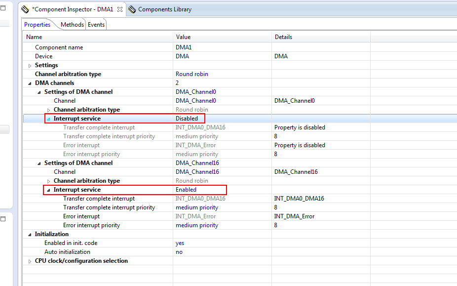

My Processor Expert K20 project uses Codewarrior for MCU version 10.6.
1.  The DMA_LDD component attached is meant to generate a DMA transfer completion interrupt, for DMA channels 0 and 16. The PE generated code erroneously passes the User Data pointer for DMA channel 0 to the ISR, when it should reference DMA channel 16 instead.

davidnemes
I have attached a cut down project that shows the code generation bug. Thanks.

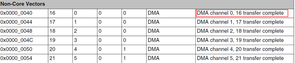

Hello David,
1) The channel 0 and channel 16 of DMA hold the same interrupt vector :
You check the register of "DMA_INT" to check the interrupt source is channel 0 or channel 16 .

davidnemes
Please see attached file for further explanation of the bug.

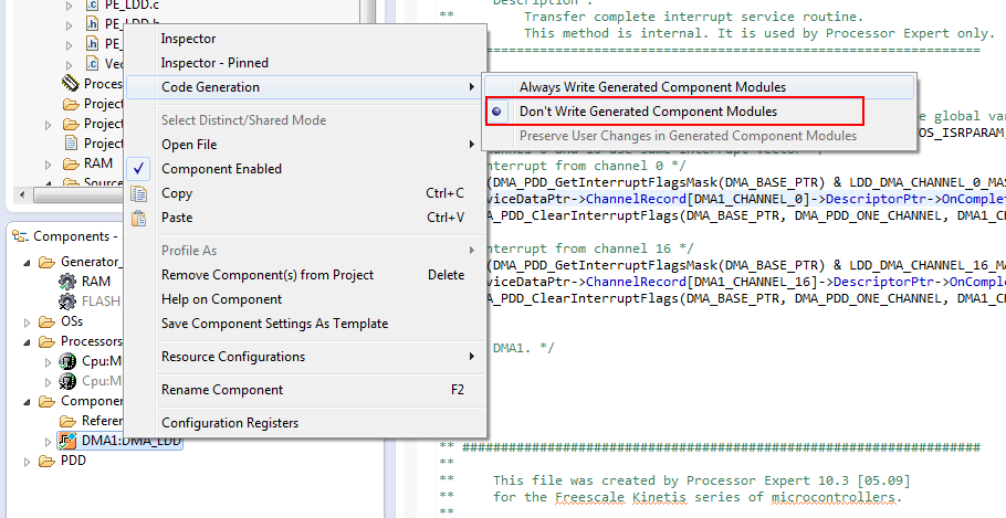

Hello David,
Yes, you are right .
On one hand , you can change it by hand  , then enable the "don't write generated component modules",
on the other hand ,  only use the channels which sharing the same interrupt vector table will
have this error,  so you can use the channels which do not use the same interrupt vector.
Alice

Hello David,
So far ,  i don't know when this bug will be fixed ,
and now , for development your project , the  workaround is change it by hand.
Alice
