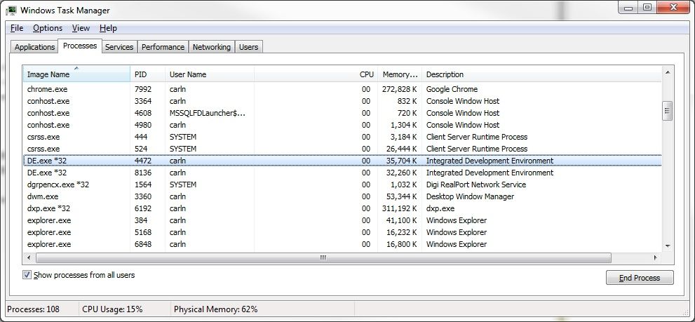

Here is a new problem which I have finally worked out, the DE.exe is locking up. I have been unable to end their processes... I was able to kill the DE monitor.exe, but not the other two, see below:
Its a 15 minute process for me to restart my server... is there a 'simple way' to kill de.exe?
