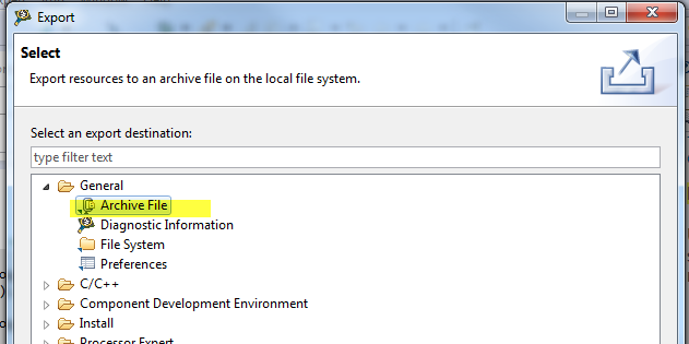

How about it if you try this:
1. Export: export project to archive file
2. Import:
- create a new workspace
- Import archive file generated by step1
How it works then?

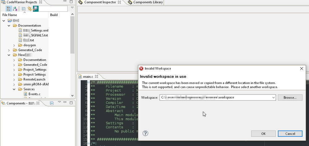

lmatte
Well, no luck either.
Note that I tried to export/re-import the workspace that already has been flagged as "invalid workspace", as I have few other chances: this is my functional workspace.
What you can see above is another small issue in importing an archive. The original project has been named as "NewABC", and I'm required to create a new project prior to import; let's say I created project "ABC", as an (almost) empty project. Importing creates a descendant tree, where my only project, with real code, is referenced as "ABC/NewABC".
I'm sure then that the problem is in my original "NewABC" project, and anyhow I try to export it the problem itself is exported too. Maybe a referred path is missing.
Most probably in the .pe file, as all the rest are my plain sources, and the error message appears a few seconds after opening workspace, like after PE decoding. At a quick(!) analysis of the 12+ thousand lines of the XML file I can't see anything like that though.
Not to be picky, but the message "There's an error and I will die an horrible death. I told you." could be improved at least as in "There's an error with this[...] file, maybe here[...]."
