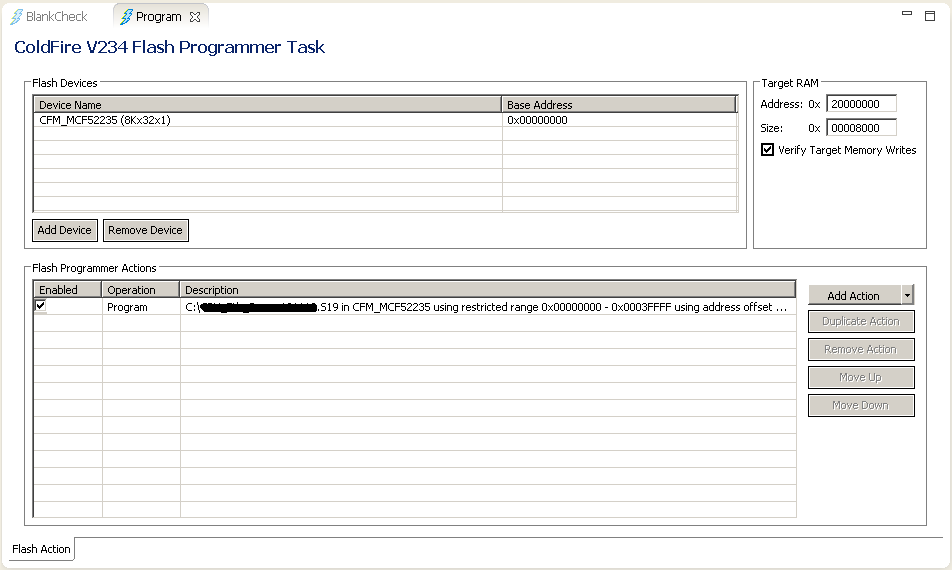

I am attaching the screenshot of the Flash Programer Task.

Also, please open the "Program" operation you have in there and take a screenshot to see the configurations. I see you have an Address Offset, have you tried with no address offset?

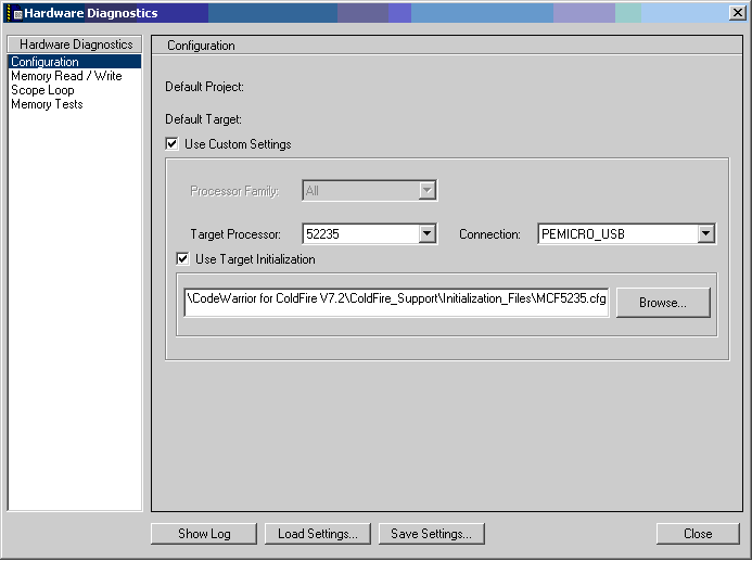

But I could use the Hardware Diagnostic tool available on this CW version and I succeeded in reading the following address from the target.

Hardware Diagnostic of CW.7.2

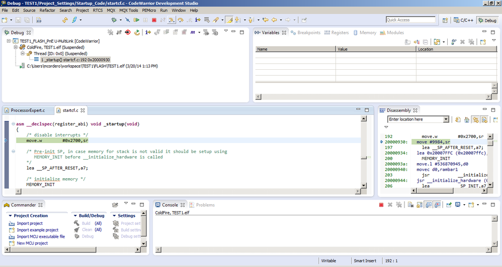

This happens when trying to debug. This window appears and I cannot neither step nor run.

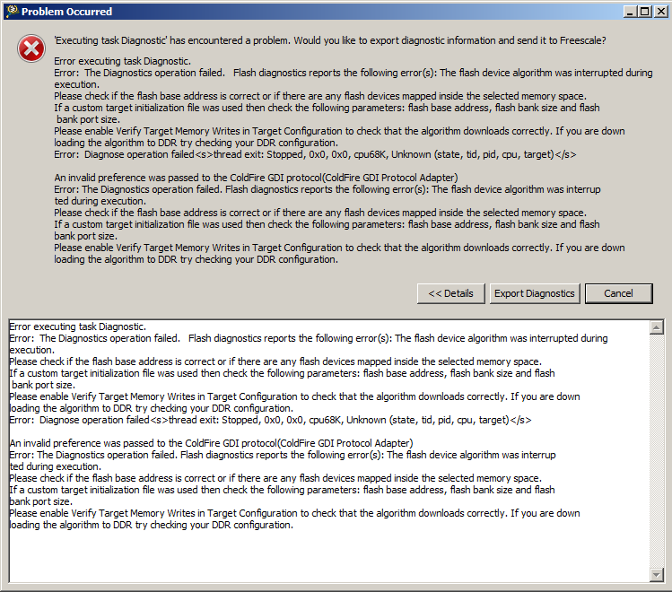

When I execute the diagnostic task, this error is thrown. Similiar to Blank Chek and Program task executions.uno- Error on diagnostic Task.PNG.png

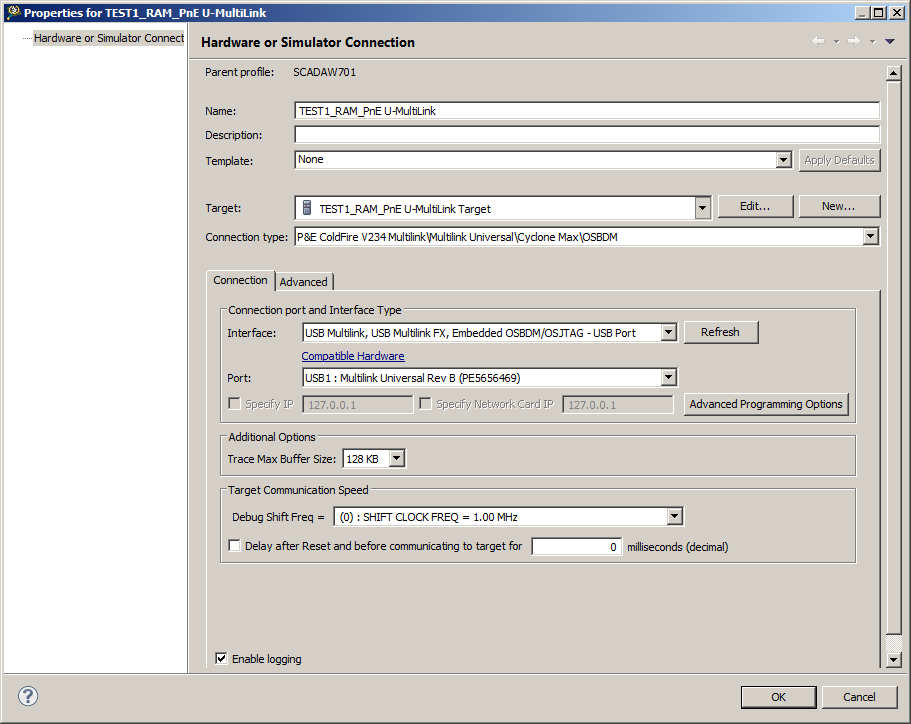

Other configurations.
The offset you mentioned was 0x00000000.

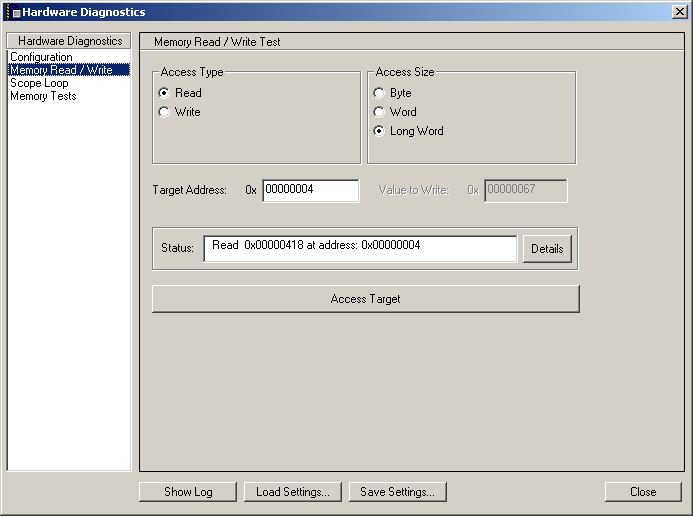

Erase Task doesn't fail. However.... With the Hardware diagnostic I read values different to 0xFF from addresses 0x00000000 ---
After erasing the flash FF values are expected isnt it?

Can you go back to CW7.2 with correct HW cofiguration set to M52235EVB.CFG? I think the reason it does not work on CW7.2 is that you have chosen the wrong cfg file (MCF5235.CFG) that does not have internal flash support (FlashBar is not enabled).
