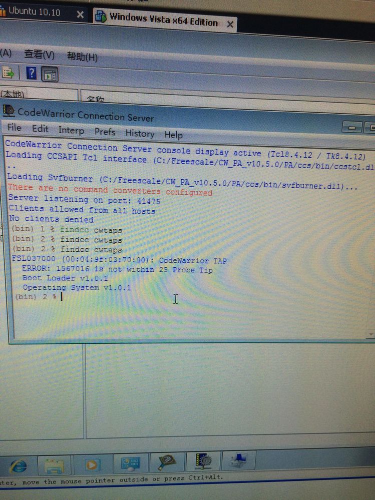

Hello, i have bought a codewarrior tap newly,but it could not be connected to the p1010 board. I used CCS to get the codewarrior tap status ,the error shows in the pic.The Probe Tip i used is CWH-CTP-COP-YE,it is also newly bought. Can you tell me what is wrong?Thank you!

Try to update the cwtap OS, it could help. To do that, in ccs console enter the command:
updatecwtap --force fsl037000
If updating cwtap doesn't help, I'm pretty sure it is a problem with the Probe, because when you have no probe connected to cwtap you don't get this error. Do you have additional probe to test?

yes,I have two cwtaps,but i have only one probe,the probe is JTAG/COP has a 16-pin connector.I used the other cwtap,the error still happened.I will try to buy another probe to test.Thank you for your answer!

According to the info it seems you're using CW for PA V10.5.
Am I right ?
You're using CodeWarrior TAP + CWH-CTP-COP-YE.
I don't know what the error ERROR:1567016 means but:
    JTAG/COP probe has a 16-pin connector
    OnCE probe has a 14-pin connector
    BDM probe has a 26-pin connector
Did you tried with a demo example created with the Project wizard (File + New) ?
