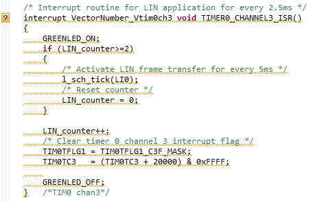

Hi community,
I'm using CodeWarrior 11.0 and when trying to run an example for the s12zvl found out a syntax error:
interrupt VectorNumber_Vtim0ch3 void TIMER0_CHANNEL3_ISR(void)
Why is this marked as a syntax error?, How should be the correct declaration?

Hello Alexis Hernandez,
What about the syntax error message?
There is a DOC about how to configure the interrupt function on CW for S12Z ,
you can have a look :
How to write interrupt function in codewarrior10.7
Or you can also refer to the demo code under CodeWarrior:
CW MCU v11.0\MCU\CodeWarrior_Examples\Processor_Expert\HCS12Z

Hi Alice,
It's nice to hear from you again. Indeed, my question is the same as the one showed in the Link that you provided (sorry, i looked for something similar but didn't find that post, otherwise i would not asked the same).
  The sysntax error message just appears in the editor (nothing in the Console or "Problems" Tab):
The provided Technical Note TN101 was really clear, now this syntax has completely sense for me.

Hello Alexis,
Sorry there isn't a DOC describe the .prm file in detail, I think you can refer to
"MCU_Build_Tools_Utilities" under CW , about the Linking Issues part.
