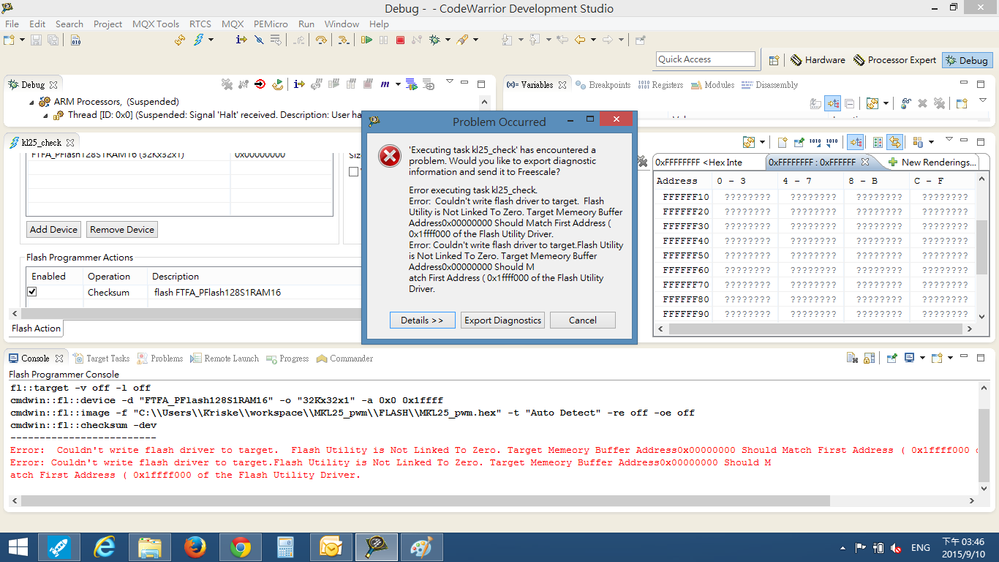

And I use the checksum with Memory Range function, but it's show below issue.
fl::target -lc "MKL25_pwm_FLASH_OpenSDA"
fl::target -b 0x0 0xffffffff
fl::target -v off -l off
cmdwin::fl::device -d "FTFA_PFlash128S1RAM16" -o "32Kx32x1" -a 0x0 0x1ffff
cmdwin::fl::image -f "C:\\Users\\Kriske\\workspace\\MKL25_pwm\\FLASH\\MKL25_pwm.hex" -t "Auto Detect" -re off -oe on -o 0xffffffff
cmdwin::fl::checksum -dev
Error:  Couldn't write flash driver to target.  Flash Utility is Not Linked To Zero. Target Memeory Buffer Address0x00000000 Should Match First Address ( 0x1ffff000 of the Flash Utility Driver.
Error: Couldn't write flash driver to target.Flash Utility is Not Linked To Zero. Target Memeory Buffer Address0x00000000 Should M

Carlos_Mendoza
Hi Kris,
The error you get happens because of the Target RAM address and size set in the Target Task, I see you set the address to 0x0 and a size of 0xffffffff, please update the address to 0x1ffff000 and the size to 0x4000, after this change you should not get any error:

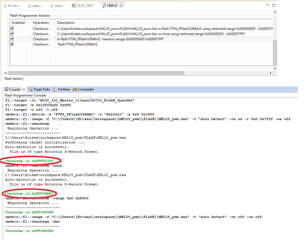

Carlos_Mendoza
Hi Kris,
The difference between the two options is the following:
File on Target: This option will calculate the checksum based on the MCU memory contents.
File on Host: This option will compute the checksum based on the corresponding binary file contents.
Both of the checksums should be the same, what I can think of is that the file that you are using as base to compute the checksum is not the same file that was programmed to the MCU and that is why you get a different checksum.
Here is a test I did, first I program the MCU, then I perform the file on target checksum and finally the file on host checksum:
Could you send me the MKL25_pwm.hex file so I can test it on my side?

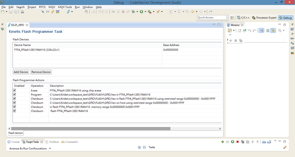

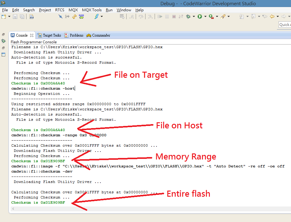

kriske
Hi Carlos

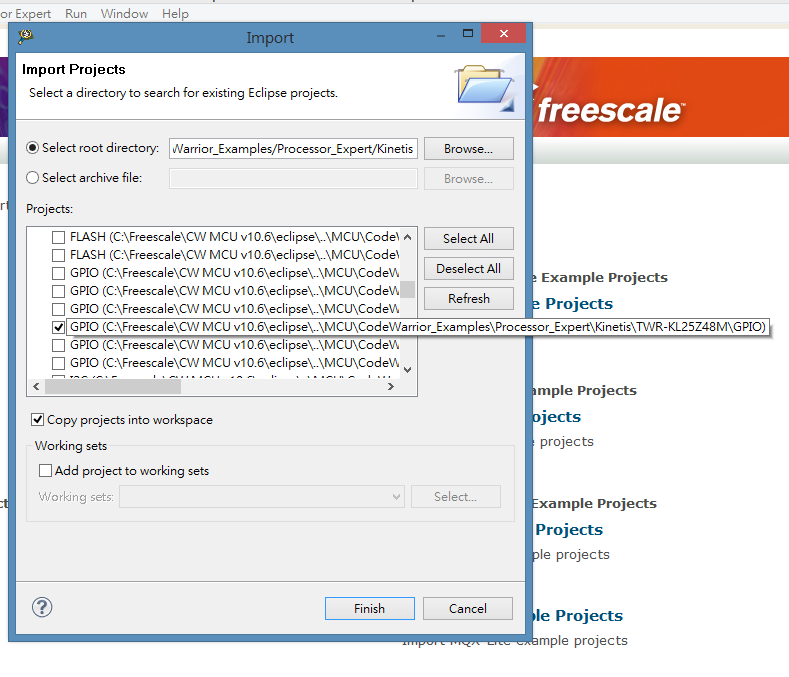

I use the Kinetis Example Projects GPIO for KL25 to try checksum again.003.png
I try File on Target, File on Host, memory range and the entire flash memory function get information.
I see the File on Target and File on Host result is difference with memory range and the entire flash, Is it right?
Could you help to explain why it have different checksum result?
3,424 Views
Carlos_Mendoza
Hi Kris,
The reason there is a difference between these options is because the File on Host and File on Target options compute the checksum over the flash section where the application was written and the Memory Range and Entire Flash options are computing the checksum over the entire flash.
Hope it helps!
Carlos Mendoza
Technical Support Engineer
