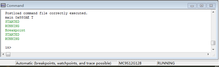

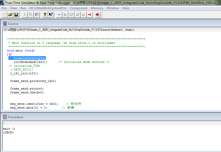

     I use the Codewarrior 5.9 for S12 to debugger,when i click Start/Continue button to RUN the code ,but it can't run .As shown in the picture below.it just can single step .Does anyone know the reason?

From your second picture, your run button is grey out, so your program already runs.
Why did you say "it can't run"?

After I click Start/Continue button , then show in the second picture ."it can't run" means the code can't run to the breakpoint i set ,still as the second picture show.

The most common reason for this problem is that the code where you set breakpoint is optimized or your program didn't run there. Please check this point.
If still has problem, please send your demo project and let me know where to set breakpoint to reproduce your problem. Thanks.
