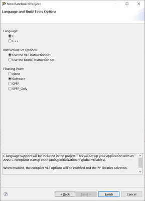

select File -> New -> Bareboard Project
Add your project name and click on Next, select MPC5646C and select Library project like this:
And that's it.
When you build the project, *.a library file is created.
Lukas

Also, can you please tell me if it's okay to choose default for this?
3,442件の閲覧回数
lukaszadrapa
You should use the same configuration for library and for your project where the library will be used.
For example, if a library is compiled for VLE instruction set, it won't work in BOOKE project, of course...
