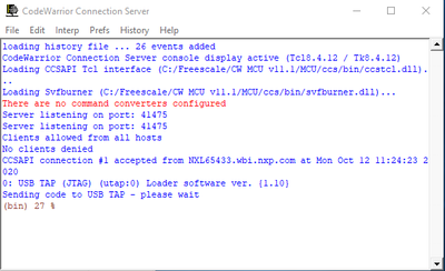

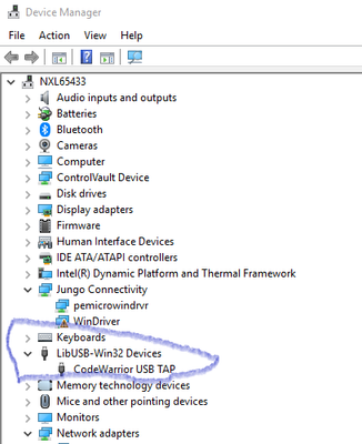

I suggest you try the following process so that we can confirm that the USBTAP device is okay.
1)after you connect the target board, sure that the USBTAP can be identified.
2)after you download the code, check the ccs tools:
