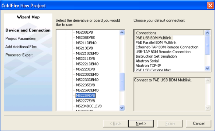

I am trying to debug an application for ColdFire MCF52233 Microcontroller using CodeWarrior v6.3 IDE. I have connected a PE Micro Cyclone MAX with USB port with my PC and its turned on. And I am doing all this stuff in a Windows XP 32-bit installation on an Oracle VM VirtualBox. So what happens is that after compiling the project, when I click on Debug>>Connect, an error always pops up saying
"PEMicroProtocolPlugin : No Parallel connection found".
How do I resolve this issue? Attaching a screenshot

Hi Muhib Raza,
Which connection did you chose as default when you created the project?
Please make sure that in you connection settings you have the correct interface selected.
Hope it helps!
