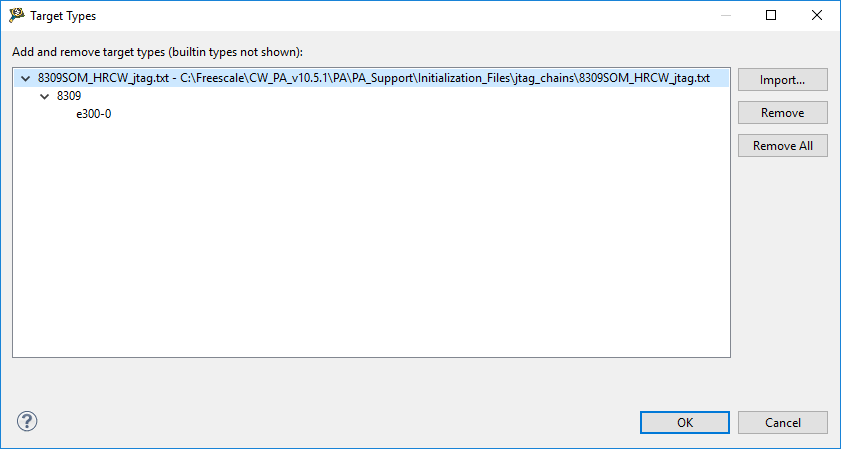

  1. Windows10 install CodeWarrior 10.5.1, CodeWarrior TAP over USB, target is 8309SOM
  2. Erase 8309SOM NOR flash UBOOT
  3. Bare project can't connect target 8309SOM. When Run display: CCSProtocolPlugin : Failed to reset the target
    [CCS last error: mpc83xx: cannot put the target into DEBUG mode ]

First probably there is no valid RCW on your target board, please refer to the section "8.4 Setting up a remote system to use a JTAG configuration file" in C:\Freescale\CW_PA_v10.5.1\PA\Help\PDF\Targeting_PA_Processors.pdf to use CodeWarrior JTAG configuration file to override RCW on the target board.
If your problem remains, please enable and capture CCS log, then send it to me to do more investigation.

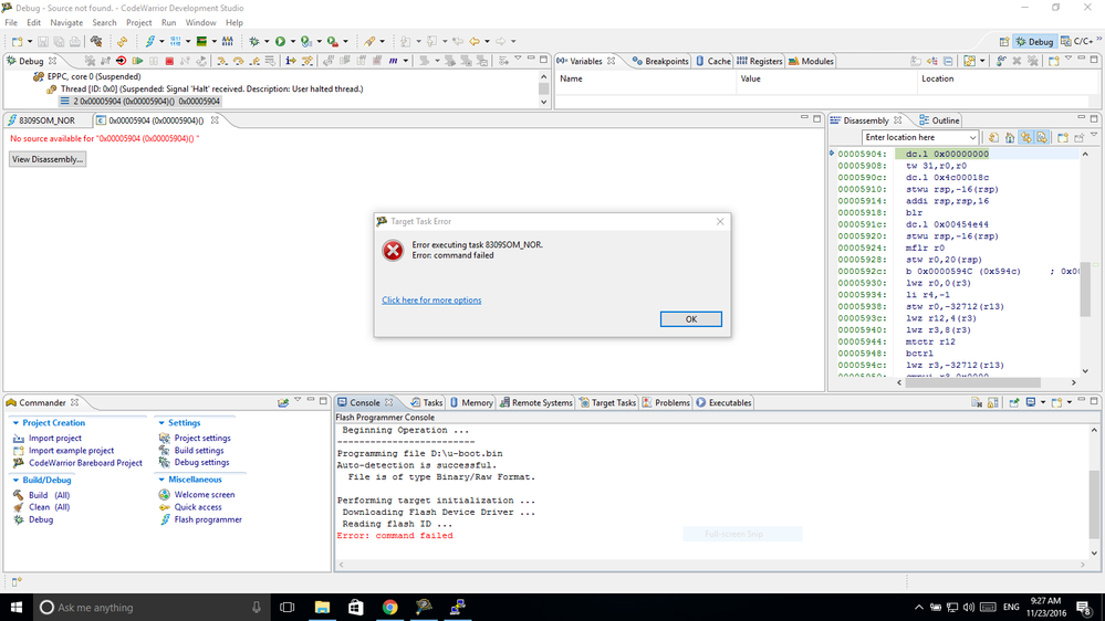

zhimingzhang
Then add program action
When execute 8309SOM Nor Flash program task failed.
Which step is error?
