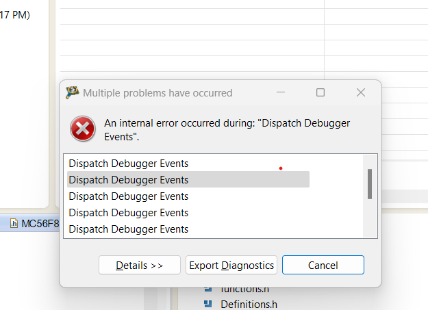

I am facing the error "An internal error occurred during "Dispatch Debugger Events".
Could you please help me to resolve the issue ?

I see that you use CodeWarrior for MCU ver11.x tools, could you tell us the part number for example MC56F8367, MC56F82748 ...and debugger probe for example USBTAP or Multilink Universal device you are using?

Hi XiangJun,
The controller used is MC56F83789 and the Multilink USB is used.
However the issue was resolved by deleting .metadat folder from the workspace.
I additionally request you to provide some guidance on Processor Expert Tool its installation and configuration along with user manual. It would be helpful since i am new to codewarrior.

Unfortunately, the MC56F83xxx including MC56F83789  supports neither Processor Expert nor quick start, but supports SDK.
Pls download SDK package from the website:
https://mcuxpresso.nxp.com/en/welcome
Hope it can help you
