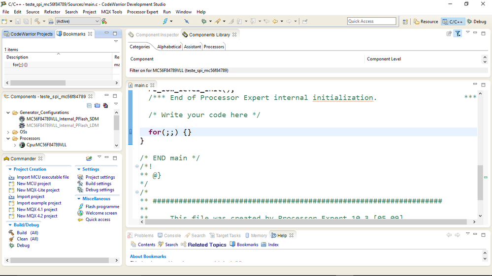

My customer ran into a weird problem in Code Warrior v. 10.7: After a project is backed up and imported in another workspace, the bookmark gets empty, all the data inside it is lost.
The same happens if we (physically) remove the project from the workspace and import the backed up project from another directory to another workspace.
He told me that he doesn't use "Project/Export" to back up the project. He just copy and paste from Windows Explorer. Maybe this is a relevant data for you.
The MCU used in the project is a MK12.
If anybody experienced such a problem and can help us...

Hi Marco,
Sorry to reply you late , as to I just got the workaround from development team.
Below are the detail steps:
0. After export and import project.
1. Exit from CW
2. Copy .metadata\.plugins\org.eclipse.core.resources\.projects\<Project name>\.markers file from old workspace to new workspace.
3. Start CW
Hope it can help.

Hello Alice,
I just created a new empty project with MK12DN128 and I could reproduce the same problem as the customer.
If you export the project as zipped to any folder and try to open in another workspace, the bookmarks just disappear.
The same occurs if you delete the project from the original workspace and try to reimport it to the same workspace.
I think you can reproduce the same issue on your side, since it is a new empty project.
Anyway, have it attached.

I think you misunderstood my question. I didn't tell you my project doesn't work anymore if I export to other workspace. Actually, the contents in Bookmarks view simply disappear if I open the project in other workspace.
"Bookmarks" view is about a view that you can add to your project in Code Warrior. This view allows you to bookmark specific lines of your project and once you click it there, it shows you where this line is at.

Hi Marco,
1. Exit from CW
3. Start CW
Hope it can help.

Sorry for the late response, Alice
We couldn't perform the tests suggested before.
Your approach worked perfectly.
Thank you very much!
