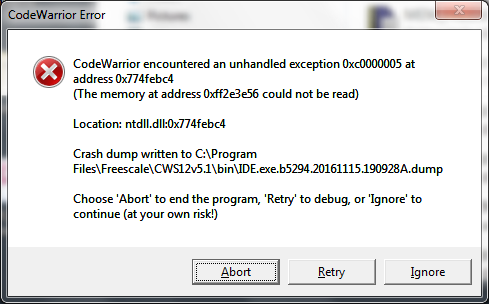

I have installed CW5.1SE on a laptop (Win7-32). No complaints during the installation process
When I attempt to create a new project from the Startup Dialog. Got the following Message. I get this when I try to create a new or open an existing project
The path is actually C:\Users\triley\AppData\Local\VirtualStore\Program Files\Freescale\CWS12v5.1\bin\IDE.exe.b5294.20161115.191030A.dump
And there are 2 files created.
190928A.dump
191030A.dump
The Dump Files are attached.
Original Attachment has been moved to: IDE.exe.b5294.20161115.191030A.dump.zip
Original Attachment has been moved to: IDE.exe.b5294.20161115.190928A.dump.zip

Hi Tim
We ever have customer met similar problem as yours on win7. He fixed his problem in this way.
-       Right click IDE.exe in the \bin folder.
-       Select    “Properties”
-       Select    “Compatibility”
-       Select    “Change settings for all users”
-       Select    “Run this program in compatibility mode for”
-       Select    “Windows Vista” from pull down menu
-       Select    “Disable visual themes” & “Disable desktop composition” &” Disable display scaling on high DPI settings”.
-       Do NOT select  “Run in 256 colors” & “Run in 640x480 screen resolution”.
-       Hit OK.
Can this also work for you?

Hello Tim,
Please uninstall it , then  re-install , use the default install path , do not change it .
Sometimes if change the path to others , maybe it can not find some files .
Hope it helps

Alice,
Thanks, I will look at this tonight. but I think I just took the default install paths.
