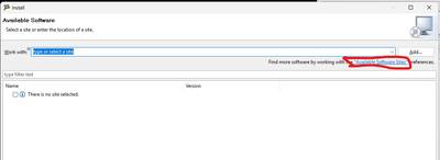

I have Code Warrior for PA 10.5.1 installed and I am trying to add QCVS (for RCW work). The installation was done as a clean new install.
When I try to use Install New Software I get errors.
Please help.
Also, links to any offline install packages do not work for me (they send me back to the NXP Code Warrior main page).
FYI - if I try to navigate to any of the update locations in a web browser I get 'Page Not Found'.
The generated error is:
Some sites could not be found. See the error log for more detail. Unable to read repository at http://freescale.com/lgfiles/updates/Eclipse/PA10_5_1/com.freescale.pa.pkt_win/content.xml. Remote host closed connection during handshake Unable to read repository at http://freescale.com/lgfiles/updates/Eclipse/PA10_5_1/com.freescale.pa.buildtools_win/content.xml. Remote host closed connection during handshake Unable to read repository at http://freescale.com/lgfiles/updates/Eclipse/PA10_5_1/com.freescale.pa.qcvs_win/content.xml. Remote host closed connection during handshake Unable to read repository at http://freescale.com/lgfiles/updates/Eclipse/PA10_5_1/com.freescale.pa.updatesite_win/content.xml. Remote host closed connection during handshake

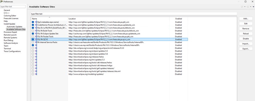

I was able to get this working by modifying where the installation new software tool gets the new software, since it's still pointing to the old freescale.com address. If you go to help -> install new software... then click on the "available Software Sites" then update some of the locations to nxp from freescale, including the QCVS you should be able to get the tool.

The Install New Software not working was because CodeWarrior installer still sets the download site as the old 'freescale.com'. I have edited and replaced with 'cache.nxp.com'. This information was very difficult to find! The QCVS installer now runs but generates MD5 hash errors (see attached). This also happens when running any of the update sites (build tools, eclipse, etc.). It also does the same in other versions of CodeWarrior (we also have v10.3). How do I sort this out?

Open CodeWarrior for PA 10.5.1 IDE and add the below repository in "Help->Install New Software->Add" to install QCVS
http://cache.nxp.com/lgfiles/updates/Eclipse/PA10_5_1/com.freescale.pa.qcvs_win
