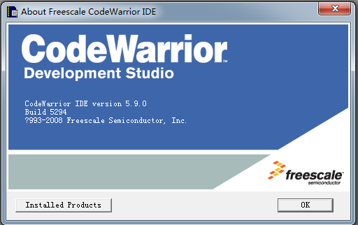

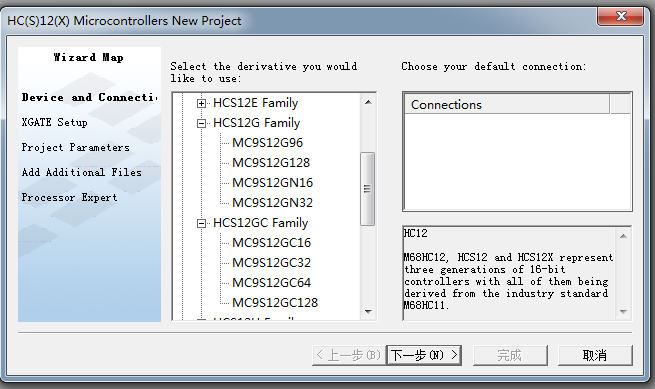

when i use CW5.9.0 to create a new project, i CAN'T find the type of my chip :MC9S12G64, is there some plug-in i need to install?  if there is one plug-in need to be installed, please give a copy to me. Any help will be appreciated!

The CodeWarrior Classic HCS12(X) v5.2 delete some chips on v5.2, you can refer to this method
add MC9S12G64 : https://community.nxp.com/message/908307
Or you can also download and install v5.1 .
Hope it helps
