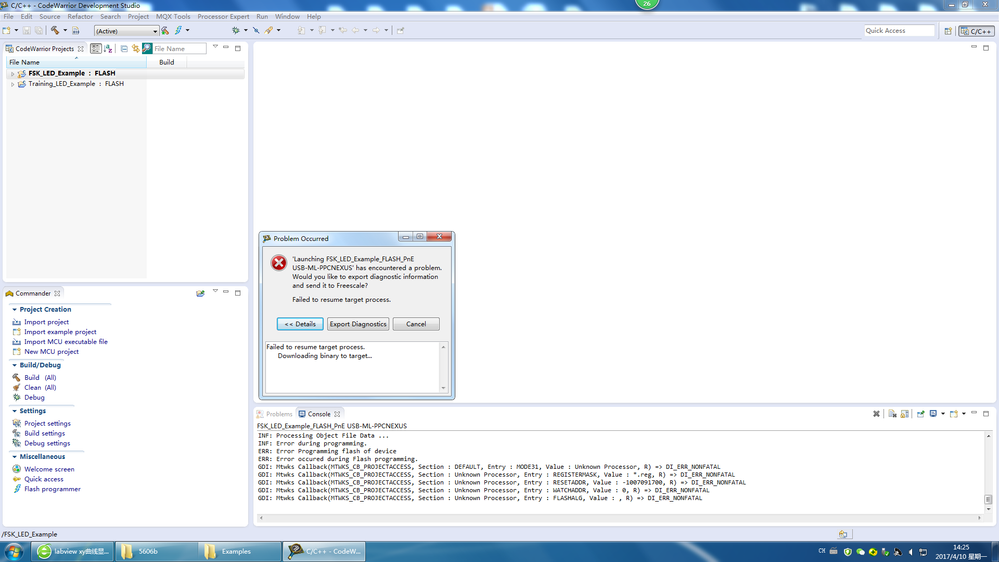

CW10.5 use FSK_LED_Example, an error occure "INF: Error during programming."

Is some switch need setting in the TRK-MPC5606B board?

could you please clarify me following points?
1) Which debug probe you use or how do you connect the board to PC?
2) Could you please check, if you have installed and updated PE Micro drivers?
3) Could you please send me high quality photo? I need to check your jumper settings.
4) Could you please share the project you try to load?
