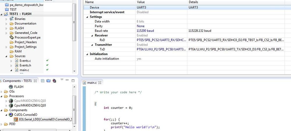

I had to make a new project with procesor expert, becauce when I copised he libraries and re-writed the void ConsoleIO_Init() there were a many others errors, main.c was clear  and errors were in that ConsoleIO.c I copied the libraries and re-writed the void ConsoleIO_Init() . The errors werent only in changed part, but in whole file.

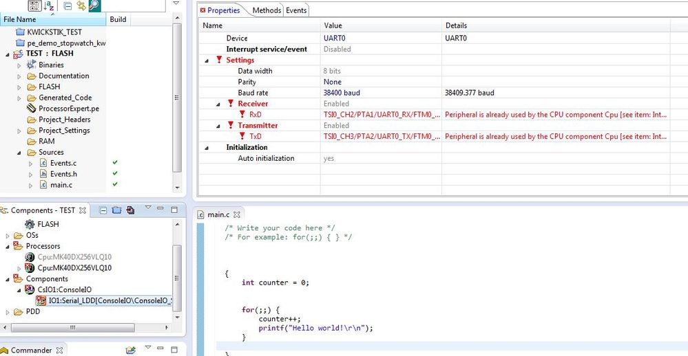

So i add consoleIO component to project, but i have issue with settings, if i make cange acording to tutorial everythnig go wrong.Výstřižek.JPG.jpg
And if i dont make any changes its works.

In your first picture you tried to select PTA1 and PTA2 as Rx and Tx pins. Those pins are configured by default for JTAG functionality (programmer), so you better do not use those.
You could instead select other pins, such as PTE9 and PTE8. If you have a Tower System (TWR-Elevators + TWR-SER), then you can have easy access to those UART signals using DB9 connector in TWR-SER.

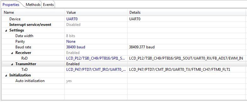

Well, i dont have whole tower, just LCD panel (kwikstik k40), so using DB9 connector isn't possible for me...I tried this settings:Výstřižek2.JPG.jpg
In my device was some default program with some apps, after debug and start its disappeared. So i guess i am rewrite it with clear progoram...Is it mean that the connection is alright, isn't?

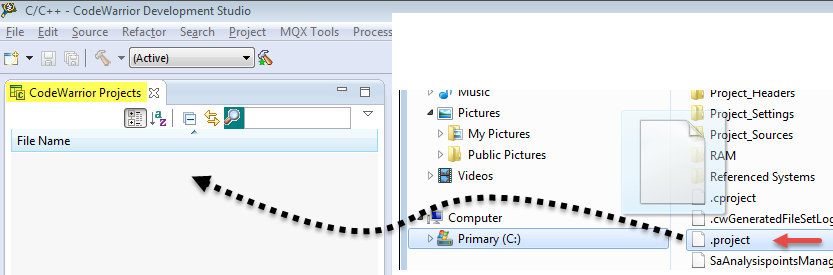

C:\Freescale\CW MCU v10.6\MCU\CodeWarrior_Examples\Kinetis_Examples\k40
Easiest way to import a project is by "Drag and Drop" of the .project from the Explorer to "CodeWarrior Projects" view:
But you can also go to "File -> Import -> General -> Existing Projects into Workspace", and actually this is the correct way.

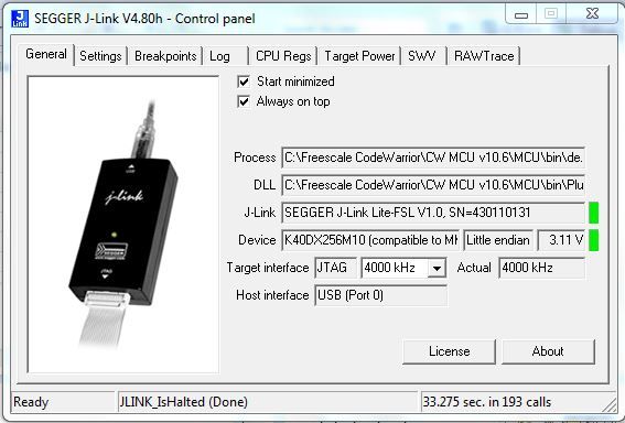

sarkamikolajkov

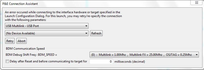

Hello, this is what i look for! :smileyhappy:  but again, i have some trouble with connection Výstřižek3.JPG.jpg
it cant  find device...
Error launching hello_world_MK40X256VMD100_INTERNAL_RAM_PnE OSJTAG
ARM GDI Protocol Adapter : Can't connect. The Debugger can not connect to the P&E device
I haven't do any changes in example project.

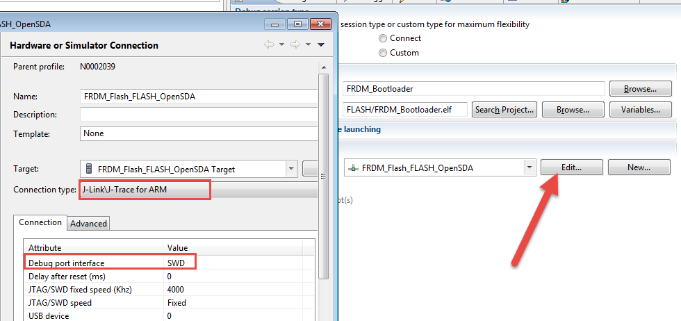

Before, in my "test project" , J-link was available:Výstřižek4.JPG.jpg
4,543件の閲覧回数
BlackNight
From your screenshots, you have your connection configured to use a P&E device, but want to use a Segger J-Link?
Make sure you configure it properly for J-Link (JTAG or SWD, depending on your target):
