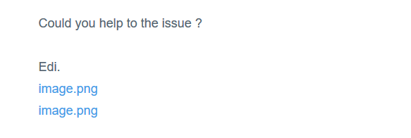

Hello edison,
Sorry I'm afraid  I can't get your picture, it just shows like below, also when click it , there is nothing.
Could you please just paste it on here or attached it .
BTW, which CW you used ?
Thanks.
