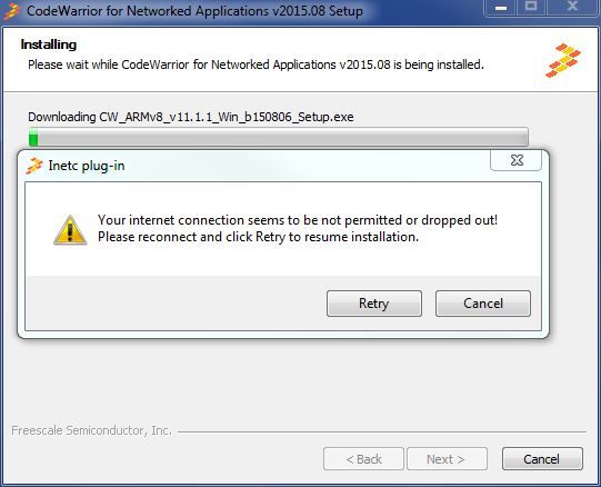

CW Networked Applications installation fails attempting to download apps (via Inetc plug-in) indicating that the internet connection (to www.freescale.com) seems to be not permitted or dropped out.

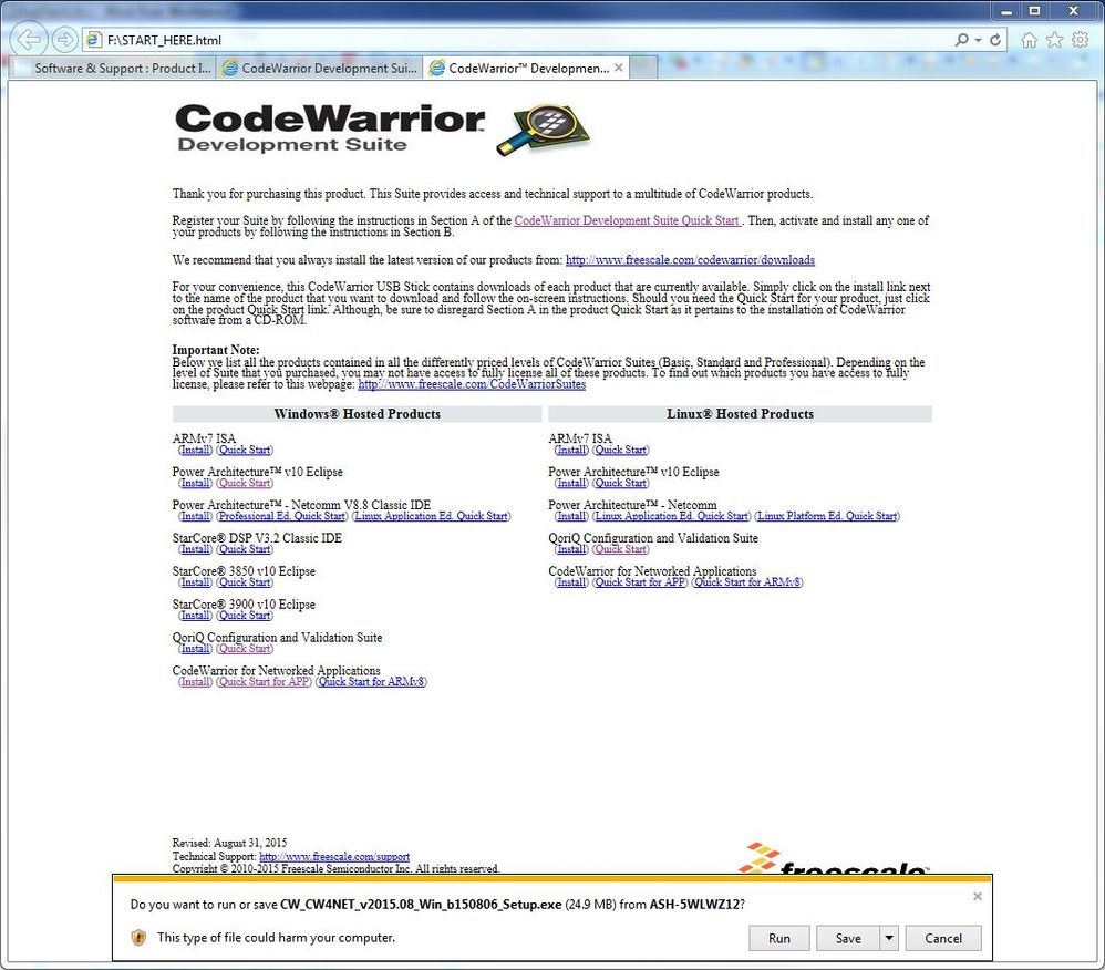

Also, this is the site I'm taken too once I click on the 'START_HERE.html' on the USB drive:

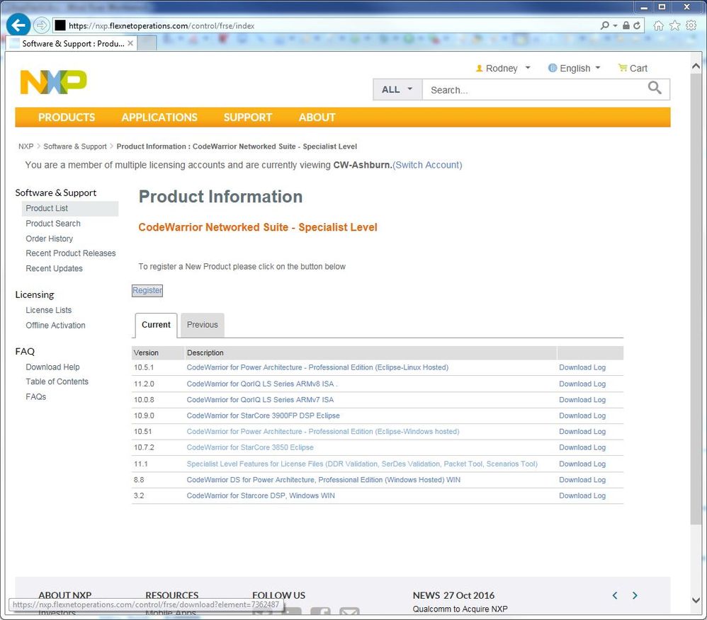

rodneymclendon
I don't see that version.  Remember, this file comes from the USB drive we recently received.  Here's is the list of apps available from the online site:

rodneymclendon
I was installing from the USB drive we received in the package with the TAP from NXP.  The file used to install with is CW_CW4NET_v2015.08_Win_b150806_Setup.exe.  I believe this is the same file obtained from the NXP website.  The screenshot is:

addiyi
That version of CW is very old. Please take the latest available version witch is CW4NET 2016.01 from www.nxp.com/cw4net
To update this version with the latest updates, after installation, go to Help > Install New Software and choose ARMv8 Eclipse Update Site - http://freescale.com/lgfiles/updates/Eclipse/11.2.0/com.freescale.armv8_win as update site.
