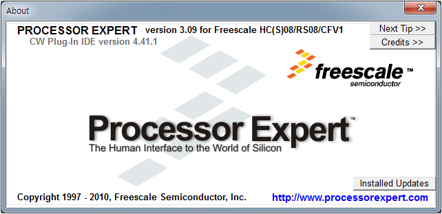

 I use CW6.3 and PE3.09 for MCF51JM128.
 i used [CW Plug-In IDE version 4.41.1]  but now the IDW version is 4.41.
 what is different between two version ?
 how can i get version 4.41.1 PE.
 I have some problem in IDE version 4.41, so I want to update to 4.41.1

PE plugin 4.41.1 has been used in service pack CW08_V6_3_CFV1_EM256_EM128_SP.exe.
install it to CW6.3 you can get PE IDE upgrade to 4.41.1.

youngcheolsong
Hello Jennie,
 Thank you for your help.
 i could solve my problem according to your help.
