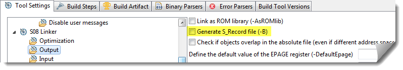

Hi all,
creating project with Processor Expert, as last step of the build the burner is invoked to create the .s19 file.
I created a new project with no Processor Expert support and I cannot find in the Properties // C/C++ Settings // Tool Settings
how to enable the creation of the .s19 file.
Could you please explain me how to do this?
Thanks for your time

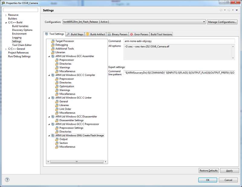

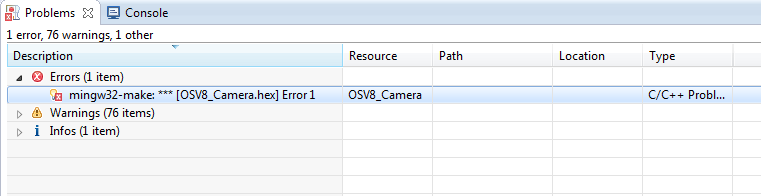

aroste
Hi all,
Find here a printscreen of the settings, the error info and the console info. It seems the ELF  file is somehow deleted.. I don't understand.

marceli1
Try to change in Output menu Output format iHEx to srec, after change Build Artifact extension elf to srec. It is what bootloader can use.

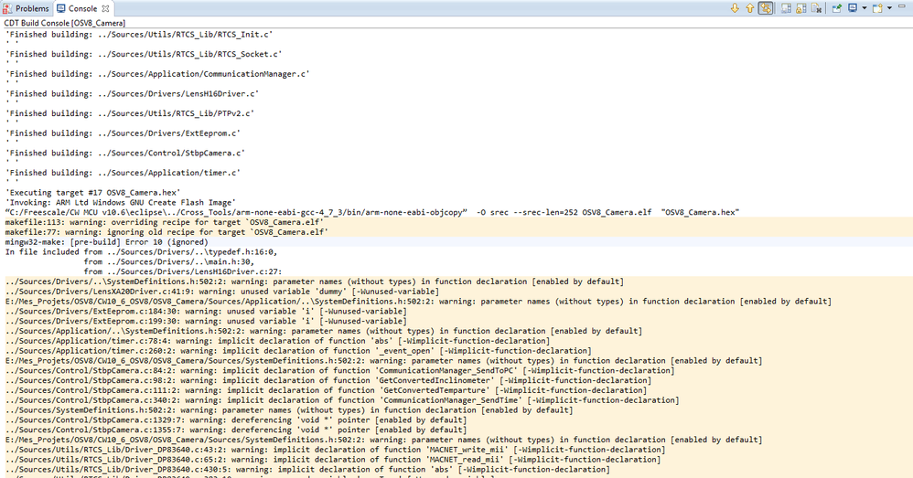

BlackNight
Could you post your complete console log (copy-paste the text)?
I believe that the link phase failed, but cannot tell from your screenshot.
Maybe you have custom options set per files/folder?
This is a problem with objcopy (see Traps and Pitfalls: No Hex/Bin/S19 File Created with GNU? | MCU on Eclipse).

aroste
Here it is:
I will check your link in parallel.
**** Build of configuration twrk60f120m_Int_Flash_Release for project OSV8_Camera ****
"C:\\Freescale\\CW MCU v10.6\\gnu\\bin\\mingw32-make" -j16 pre-build main-build

'Executing target #17 OSV8_Camera.hex'
'Invoking: ARM Ltd Windows GNU Create Flash Image'
“C:/Freescale/CW MCU v10.6\eclipse\../Cross_Tools/arm-none-eabi-gcc-4_7_3/bin/arm-none-eabi-objcopy”  -O srec --srec-len=252 OSV8_Camera.elf  "OSV8_Camera.hex"
makefile:113: warning: overriding recipe for target `OSV8_Camera.elf'
makefile:77: warning: ignoring old recipe for target `OSV8_Camera.elf'
mingw32-make: [pre-build] Error 10 (ignored)

mingw32-make: *** [OSV8_Camera.hex] Error 1

aroste
I have a project based on K60F120M that was "working" with CW10.5 and MQX4.0.  As I have some problem with TCP IP /UDP connections I'm trying with CW10.6 and MQX4.1.1.
For that I created I new project in my new environment and after that I updated the project files with my files. (to have all new from CW10.6)
I finally succeded in building libraries and project and run it in debug mode.  Now I'm trying the release version.
I found here that it needs to add in the project properties the "Create Flash Image" to get the srecord file to download with my bootloader.
My problem is that I always get an error and once the option "Create Flash Image" is activated I cannot get neither the ELF or HEX software file.
I am lost.  Nothing in the links I found explain that...

aroste
Thanks for the video, it is exactly what I did. It seems that the ELF file disappear and then it's not find to create the S19.
As I still have to get working with some points I went back on CW10.5 and MQX4.0.1.  If you have some other comments or suggestions it's welcome, I will try ASAP again.

aroste
Hi Pascal,
Yes I know.  :-)    I was thinking about that after the renaming. (option in commands to do it automatically)
But I tried with renaming, just create the HEX-file as you mentionned and it crashes.  I will try again today.

Jorge_Gonzalez
Hello Francesco:
There is indeed an option to create S19 file. This is in Project -> Properties -> C/C++ Build -> Settings -> Tool Settings -> S08 Linker -> Output:
However, I have seen that for S08 projects, the burner is invoked by default from the makefile, so the S19 file should be generated without that option enabled. If you are not getting the S19 file generated, it could be caused by Per-File settings, explained by Erich himself at the next tutorial:
With custom file settings the makefile is not generated properly.
Regards!,
Jorge Gonzalez
